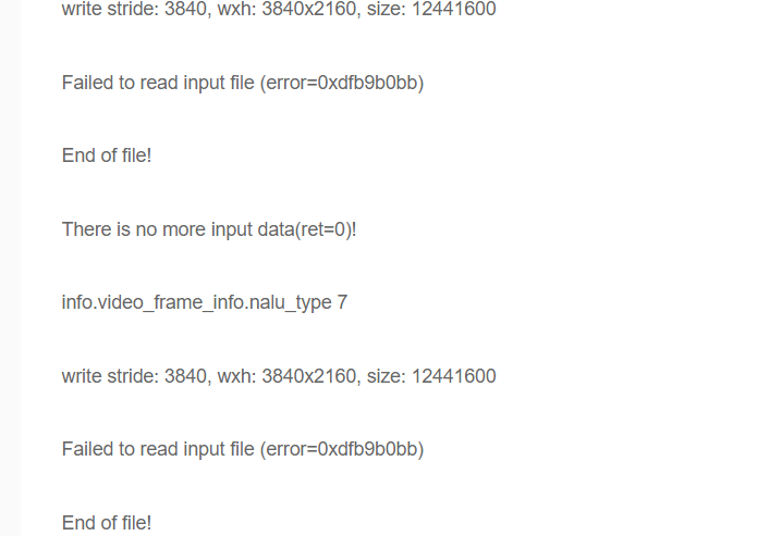

Failed to read input file (error=0xdfb9b0bb)
End of file!
There is no more input data(ret=0)!
info.video_frame_info.nalu_type 7
write stride: 3840, wxh: 3840x2160, size: 12441600
End of file!
End of file!
End of file!
End of file!
End of file!
write stride: 0, wxh: 3840x2160, size: 0
There is no more output data!
    这个看着不是因为没有输入的数据么
