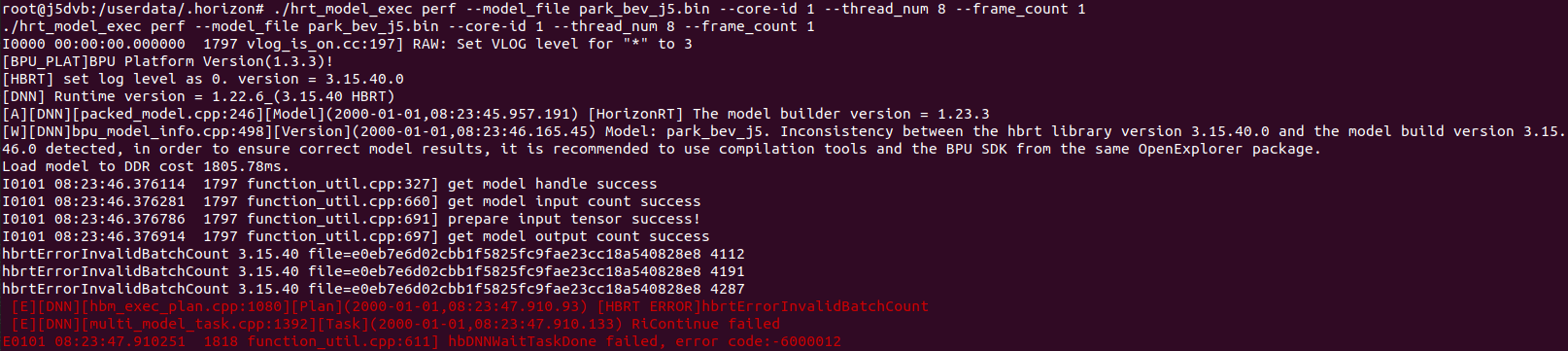

4. 问题具体描述:板端运行出现以下错误
root@j5dvb:/userdata/.horizon# ./hrt_model_exec perf --model_file park_bev_j5.bin --core-id 1 --thread_num 8 --frame_count 1
I0000 00:00:00.000000 1797 vlog_is_on.cc:197] RAW: Set VLOG level for "*" to 3
[BPU_PLAT]BPU Platform Version(1.3.3)!
[HBRT] set log level as 0. version = 3.15.40.0
[DNN] Runtime version = 1.22.6_(3.15.40 HBRT)
[A][DNN][packed_model.cpp:246][Model](2000-01-01,08:23:45.957.191) [HorizonRT] The model builder version = 1.23.3
[W][DNN]bpu_model_info.cpp:498][Version](2000-01-01,08:23:46.165.45) Model: park_bev_j5. Inconsistency between the hbrt library version 3.15.40.0 and the model build version 3.15.46.0 detected, in order to ensure correct model results, it is recommended to use compilation tools and the BPU SDK from the same OpenExplorer package.
Load model to DDR cost 1805.78ms.
I0101 08:23:46.376114 1797 function_util.cpp:327] get model handle success
I0101 08:23:46.376281 1797 function_util.cpp:660] get model input count success
I0101 08:23:46.376786 1797 function_util.cpp:691] prepare input tensor success!
I0101 08:23:46.376914 1797 function_util.cpp:697] get model output count success
hbrtErrorInvalidBatchCount 3.15.40 file=e0eb7e6d02cbb1f5825fc9fae23cc18a540828e8 4112
hbrtErrorInvalidBatchCount 3.15.40 file=e0eb7e6d02cbb1f5825fc9fae23cc18a540828e8 4191
hbrtErrorInvalidBatchCount 3.15.40 file=e0eb7e6d02cbb1f5825fc9fae23cc18a540828e8 4287
 [E][DNN][hbm_exec_plan.cpp:1080][Plan](2000-01-01,08:23:47.910.93) [HBRT ERROR]hbrtErrorInvalidBatchCount
 [E][DNN][multi_model_task.cpp:1392][Task](2000-01-01,08:23:47.910.133) RiContinue failed
E0101 08:23:47.910251 1818 function_util.cpp:611] hbDNNWaitTaskDone failed, error code:-6000012

    请更新一下板端的推理库,先保证编译和推理的hbrt版本一致
