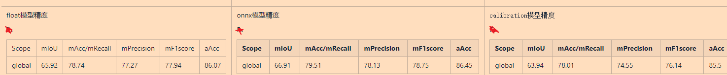

      float,calibration,qat,int_infer 精度都和float差不多,
      2024-08-15
