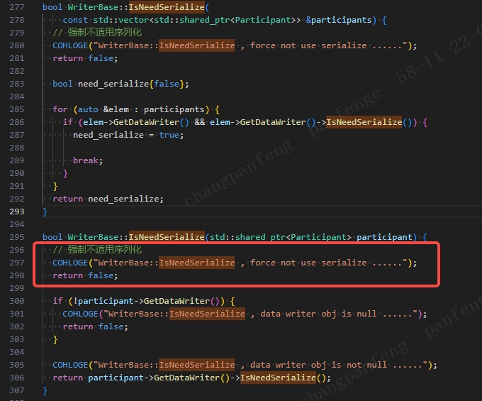

4. 问题描述: 插件 DataWriter 类的发送数据接口 AsyncWrite() 的无法关闭序列化功能,DataWriter类的IsNeedSerialize() 接口返回为false。请问一下插件 DataWriter 类的IsNeedSerialize() 接口 的调用链路是否为: Writer::ParticipantWrite -> WriterBase::IsNeedSerialize -> 插件 DataWriter::IsNeedSerialize()

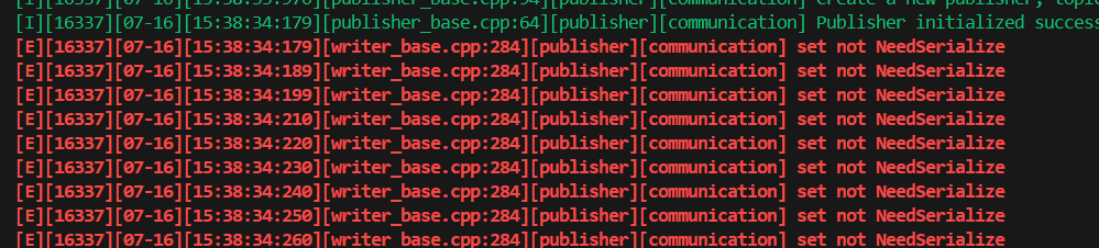

在writer_base 增加的日志,不清楚是为何调试时未输出,强制返回false也未生效。编译后的如下几个库已copy到测试程序可执行文件同一目录中.
libcommunication-static.a  libcommunication.so     libcommunication.so.4    libcommunication.so.4.10.5
5. 示例代码:
bool WriterBase::IsNeedSerialize(
    const std::vector> &participants) {
  // 强制不适用序列化
  COHLOGE("WriterBase::IsNeedSerialize , force not use serialize ......");
  return false;
  bool need_serialize{false};
  for (auto &elem : participants) {
    if (elem->GetDataWriter() && elem->GetDataWriter()->IsNeedSerialize()) {
      need_serialize = true;
      break;
  return need_serialize;
bool WriterBase::IsNeedSerialize(std::shared_ptr participant) {
  // 强制不适用序列化
  return false;
  if (!participant->GetDataWriter()) {
    COHLOGE("WriterBase::IsNeedSerialize , data writer obj is null ......");
    return false;
  COHLOGE("WriterBase::IsNeedSerialize , data writer obj is not null ......");
  return participant->GetDataWriter()->IsNeedSerialize();
