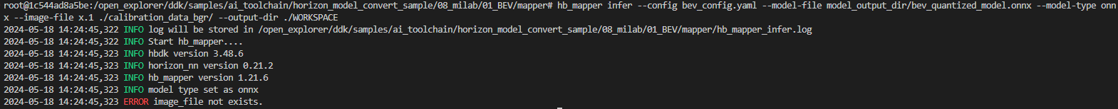

运行的命令:hb_mapper infer --config bev_config.yaml --model-file model_output_dir/bev_quantized_model.onnx --model-type onnx --image-file x.1 ./calibration_data_bgr --output-dir ./WORKSPACE
报错信息:在使用hb_mapper infer 时出现报错
2024-05-18 14:24:45,323 file: tool_utils.py func: tool_utils line No: 132 Traceback (most recent call last):
  File "/usr/local/lib/python3.8/dist-packages/horizon_tc_ui/utils/tool_utils.py", line 129, in __decorator
    func(*args, **kargs)
  File "/usr/local/lib/python3.8/dist-packages/horizon_tc_ui/hb_mapper.py", line 203, in infer
    InferRunner(config, model_file, model_type, image_file, input_layout,
  File "/usr/local/lib/python3.8/dist-packages/horizon_tc_ui/hb_mapper_infer.py", line 31, in __init__
    raise ValueError('image_file not exists.')
ValueError: image_file not exists.请问问题出在哪里
    输入图片路径不对吧?
