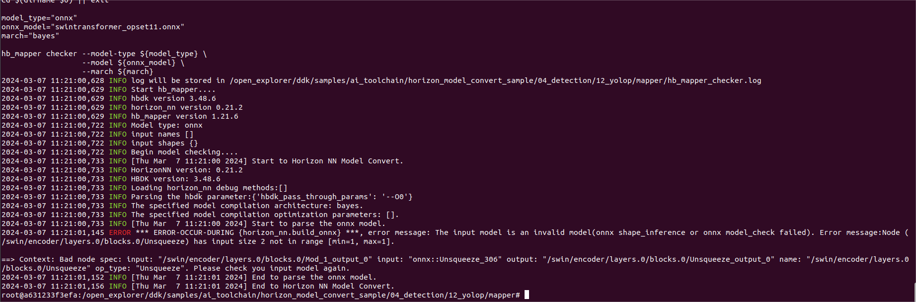

4. 问题具体描述:ERROR-OCCUR-DURING {horizon_nn.build_onnx} ***, error message: The input model is an invalid model(onnx shape_inference or onnx model_check failed). Error message:Node (/swin/encoder/layers.0/blocks.0/Unsqueeze) has input size 2 not in range [min=1, max=1]

    ONNX模型检测的过程中与没有啥问题?
    2024-03-01
    • 我爱邢宝宝i回复kotei左文亮:
      ERROR *** ERROR-OCCUR-DURING {horizon_nn.build_onnx} ***, error message: The input model is an invalid model(onnx shape_inference or onnx model_check failed). Error message:Node (/swin/encoder/layers.0/blocks.0/Unsqueeze) has input size 2 not in range [min=1, max=1]. ==> Context: Bad node spec: input: "/swin/encoder/layers.0/blocks.0/Mod_1_output_0" input: "onnx::Unsqueeze_306" output: "/swin/encoder/layers.0/blocks.0/Unsqueeze_output_0" name: "/swin/encoder/layers.0/blocks.0/Unsqueeze" op_type: "Unsqueeze". Please check you input model again.

    OE68版本,使用onnx模型检测发现unsqueeze算子会被转换成Reshape,BPU约束如下:1. 该算子支持int16输入输出。2. 支持1-10维输入输出
    初步解决思路是更换次算子的输入输出或者替换次算子,在重新生成onnx模型进行转化。
    2024-03-07
