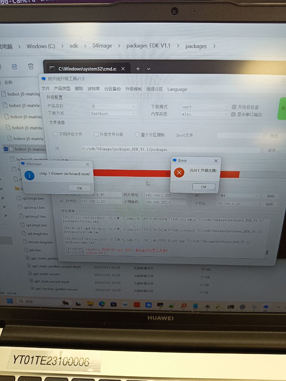

  1. 系统软件版本: gonghongyan@soc debug 20230131-222433
  2. 问题涉及的技术领域: 升级
  3. 问题描述:用地平线升级工具v1.9升级J5 EDK失败
  4. 复现概率:必现
  5. IP是通的。可以ping 通J5的IP地址 192.168.1.40 。
不知道为什么在刷app.img的时候失败了
  1. 提供必要的问题日志: 截图
  2. 软件上是否有做自定义修改:没有,客服给的版本

  • szc
    [2023-12-14 13:42:55,986] [MainThread] [DEBUG] hbupdate-gui.py:1511 uart
    [2023-12-14 13:42:55,986] [MainThread] [DEBUG] hbupdate-gui.py:1512 True
    [2023-12-14 13:42:55,986] [MainThread] [DEBUG] hbupdate-gui.py:1513 True
    [2023-12-14 13:42:55,986] [MainThread] [DEBUG] hbupdate-gui.py:1516 =================
    [2023-12-14 13:42:55,986] [MainThread] [DEBUG] hbupdate-gui.py:1517 C:/edk/04image/packages_EDK_V1.1/packages
    [2023-12-14 13:42:55,986] [MainThread] [DEBUG] hbupdate-gui.py:1518 COM4
    [2023-12-14 13:42:55,986] [MainThread] [DEBUG] hbupdate-gui.py:1519 192.168.1.20
    [2023-12-14 13:42:55,986] [MainThread] [DEBUG] hbupdate-gui.py:1520 192.168.1.40
    [2023-12-14 13:42:55,986] [MainThread] [DEBUG] hbupdate-gui.py:1521 192.168.1.20
    [2023-12-14 13:42:55,986] [MainThread] [DEBUG] hbupdate-gui.py:1522 255.255.255.0
    [2023-12-14 13:42:55,986] [MainThread] [DEBUG] hbupdate-gui.py:1523 192.168.1.255
    [2023-12-14 13:42:55,986] [MainThread] [DEBUG] hbupdate-gui.py:1541 invalid MAC
    [2023-12-14 13:42:58,678] [Update0] [INFO] Board.py:148 partitions : ['sbl', 'all', 'gpt'], len: 3
    [2023-12-14 13:42:58,678] [Update0] [INFO] Board.py:150 checking board...
    [2023-12-14 13:42:58,687] [Update0] [INFO] Board.py:153 Start to enter the branch of different download modes...
    [2023-12-14 13:42:58,687] [Update0] [INFO] uart_update.py:83 prepare to entry UART download mode
    [2023-12-14 13:42:58,687] [Update0] [INFO] uart_update.py:84 please wait a minute...
    [2023-12-14 13:43:05,902] [Update0] [INFO] uart_update.py:61 in UART download mode.
    [2023-12-14 13:43:05,902] [Update0] [INFO] uart_update.py:72 start to downloading spl: C:/edk/04image/packages_EDK_V1.1/packages\spl.img4.bin !!!
    [2023-12-14 13:43:06,904] [Update0] [INFO] xmodem.py:61 xmodem transmit use CRC
    [2023-12-14 13:43:08,808] [Update0] [DEBUG] uart_update.py:116 spl marked as:C:/edk/04image/packages_EDK_V1.1/packages\spl.img4.bin, gpt marked as:gpt_main-secure.img
    [2023-12-14 13:43:08,808] [Update0] [INFO] uart_update.py:139 cannot find C:/edk/04image/packages_EDK_V1.1/packages/uboot-env.bin file, start to use data boot files!
    [2023-12-14 13:43:08,824] [Update0] [INFO] uart_boot.py:131 send C:/edk/04image/packages_EDK_V1.1/packages/mcore.img.bin before send x2dbg.
    [2023-12-14 13:43:09,043] [Update0] [DEBUG] uart_boot.py:148 C:/edk/04image/packages_EDK_V1.1/packages/mcore.img.bin start 10.000000 end 11.000000
    [2023-12-14 13:43:09,043] [Update0] [INFO] uart_boot.py:149 start load C:/edk/04image/packages_EDK_V1.1/packages/mcore.img.bin
    [2023-12-14 13:43:13,295] [Update0] [INFO] xmodem.py:61 xmodem transmit use CRC
    [2023-12-14 13:43:14,078] [Update0] [INFO] uart_boot.py:167 load success
    [2023-12-14 13:43:14,078] [Update0] [INFO] uart_boot.py:127 wait download...
    [2023-12-14 13:43:16,089] [Update0] [INFO] uart_boot.py:143 wait string before send C:/edk/04image/packages_EDK_V1.1/packages/ddrc.img.bin.
    [2023-12-14 13:43:16,089] [Update0] [DEBUG] uart_boot.py:148 C:/edk/04image/packages_EDK_V1.1/packages/ddrc.img.bin start 11.000000 end 12.561424
    [2023-12-14 13:43:16,089] [Update0] [INFO] uart_boot.py:149 start load C:/edk/04image/packages_EDK_V1.1/packages/ddrc.img.bin
    [2023-12-14 13:43:18,630] [Update0] [INFO] xmodem.py:61 xmodem transmit use CRC
    [2023-12-14 13:43:21,263] [Update0] [INFO] uart_boot.py:167 load success
    [2023-12-14 13:43:21,263] [Update0] [INFO] uart_boot.py:143 wait string before send C:/edk/04image/packages_EDK_V1.1/packages/bl31.img.bin.
    [2023-12-14 13:43:21,748] [Update0] [DEBUG] uart_boot.py:148 C:/edk/04image/packages_EDK_V1.1/packages/bl31.img.bin start 12.561424 end 22.151441
    [2023-12-14 13:43:21,748] [Update0] [INFO] uart_boot.py:149 start load C:/edk/04image/packages_EDK_V1.1/packages/bl31.img.bin
    [2023-12-14 13:43:25,996] [Update0] [INFO] xmodem.py:61 xmodem transmit use CRC
    [2023-12-14 13:43:30,999] [Update0] [INFO] xmodem.py:240 loaded 30%, remaining time is 0m 11s
    [2023-12-14 13:43:36,002] [Update0] [INFO] xmodem.py:240 loaded 62%, remaining time is 0m 6s
    [2023-12-14 13:43:41,008] [Update0] [INFO] xmodem.py:240 loaded 93%, remaining time is 0m 1s
    [2023-12-14 13:43:42,088] [Update0] [INFO] uart_boot.py:167 load success
    [2023-12-14 13:43:42,088] [Update0] [INFO] uart_boot.py:143 wait string before send C:/edk/04image/packages_EDK_V1.1/packages/uboot.img.bin.
    [2023-12-14 13:43:42,389] [Update0] [DEBUG] uart_boot.py:148 C:/edk/04image/packages_EDK_V1.1/packages/uboot.img.bin start 22.151441 end 30.000000
    [2023-12-14 13:43:42,389] [Update0] [INFO] uart_boot.py:149 start load C:/edk/04image/packages_EDK_V1.1/packages/uboot.img.bin
    [2023-12-14 13:43:46,636] [Update0] [INFO] xmodem.py:61 xmodem transmit use CRC
    [2023-12-14 13:43:51,638] [Update0] [INFO] xmodem.py:240 loaded 35%, remaining time is 0m 9s
    [2023-12-14 13:43:56,642] [Update0] [INFO] xmodem.py:240 loaded 71%, remaining time is 0m 4s
    [2023-12-14 13:44:00,694] [Update0] [INFO] uart_boot.py:167 load success
    [2023-12-14 13:44:00,694] [Update0] [INFO] uart_boot.py:143 wait string before send data/board_config/j5/boot_config/boot_file/uboot-env.bin.
    [2023-12-14 13:44:00,992] [Update0] [DEBUG] uart_boot.py:148 data/board_config/j5/boot_config/boot_file/uboot-env.bin start 30.000000 end 30.000000
    [2023-12-14 13:44:00,992] [Update0] [INFO] uart_boot.py:149 start load data/board_config/j5/boot_config/boot_file/uboot-env.bin
    [2023-12-14 13:44:05,231] [Update0] [INFO] xmodem.py:61 xmodem transmit use CRC
    [2023-12-14 13:44:05,341] [Update0] [INFO] uart_boot.py:167 load success
    [2023-12-14 13:44:05,341] [Update0] [INFO] core.py:92 [com] xyzModem - CRC mode, 0(SOH)/4(STX)/0(CAN) packets, 1 retries
    [2023-12-14 13:44:05,503] [Update0] [DEBUG] core.py:175 try entry linux shell
    [2023-12-14 13:44:06,520] [Update0] [INFO] core.py:92 [com] Loaded 4096 bytes
    [2023-12-14 13:44:06,520] [Update0] [INFO] core.py:92 [com] [BL31:1970:1:1:0:1:0:14400](0) NOTICE: BL31: v2.1(debug):j5-fiq-test-413-g5b2a6e6fd
    [2023-12-14 13:44:06,520] [Update0] [INFO] core.py:92 [com] [BL31:1970:1:1:0:1:0:15444](0) NOTICE: BL31: Built : 13:41:43, Jul 25 2022
    [2023-12-14 13:44:06,520] [Update0] [INFO] core.py:92 [com] [BL31:1970:1:1:0:1:0:16383](0) INFO: GICv3 without legacy support detected. ARM GICv3 driver initialized in EL3
    [2023-12-14 13:44:06,520] [Update0] [INFO] core.py:92 [com] [BL31:1970:1:1:0:1:0:17838](0) INFO: GICv3 GICTNS support enable.
    [2023-12-14 13:44:06,520] [Update0] [INFO] core.py:92 [com] [BL31:1970:1:1:0:1:0:18731](0) INFO: tee_fw_fusa_init: tee fw stl inited, module id 5!
    [2023-12-14 13:44:06,520] [Update0] [INFO] core.py:92 [com] [BL31:1970:1:1:0:1:0:19874](0) INFO: tee_fw_fusa_init: tee fw stl inited, module id 2!
    [2023-12-14 13:44:06,520] [Update0] [INFO] core.py:92 [com] [BL31:1970:1:1:0:1:0:20990](0) INFO: tee_fw_fusa_init: tee fw stl inited, module id 3!
    [2023-12-14 13:44:06,520] [Update0] [INFO] core.py:92 [com] [BL31:1970:1:1:0:1:0:22105](0) INFO: tee_fw_fusa_init: tee fw stl inited, module id 4!
    [2023-12-14 13:44:06,520] [Update0] [INFO] core.py:92 [com] [BL31:1970:1:1:0:1:0:23203](0) NOTICE: tee_sectrl_fusa_setup_ops: set sectrl fusa ops
    [2023-12-14 13:44:06,520] [Update0] [INFO] core.py:92 [com] [BL31:1970:1:1:0:1:0:24271](0) INFO: tee_sectrl_fusa_scramble_check: tee sectrl stl scramble check pass!
    [2023-12-14 13:44:06,520] [Update0] [INFO] core.py:92 [com] [BL31:1970:1:1:0:1:0:25592](0) INFO: tee_sectrl_fusa_init: tee sectrl stl inited
    [2023-12-14 13:44:06,520] [Update0] [INFO] core.py:92 [com] [BL31:1970:1:1:0:1:0:26640](0) INFO: BL31: Initialising Exception Handling Framework
    [2023-12-14 13:44:06,520] [Update0] [INFO] core.py:92 [com] [BL31:1970:1:1:0:1:0:27717](0) INFO: BL31: Initializing runtime services
    [2023-12-14 13:44:06,520] [Update0] [INFO] core.py:92 [com] [BL31:1970:1:1:0:1:0:28700](0) INFO: hobotd malloc pool setup at 0x80270000, size:0x200000
    [2023-12-14 13:44:06,520] [Update0] [INFO] core.py:92 [com] [BL31:1970:1:1:0:1:0:29846](0) INFO: hobotd sram mempool setup at 0x20018000, size:0x2000
    [2023-12-14 13:44:06,520] [Update0] [INFO] core.py:92 [com] pdu_get_version version 0x8965
    [2023-12-14 13:44:06,520] [Update0] [INFO] core.py:92 [com] spacc->config.num_sec_ctx: 0
    [2023-12-14 13:44:06,520] [Update0] [INFO] core.py:92 [com] SPACC ID: (00008965)
    [2023-12-14 13:44:06,520] [Update0] [INFO] core.py:92 [com] MAJOR : 6
    [2023-12-14 13:44:06,520] [Update0] [INFO] core.py:92 [com] MINOR : 5
    [2023-12-14 13:44:06,520] [Update0] [INFO] core.py:92 [com] QOS : 1
    [2023-12-14 13:44:06,520] [Update0] [INFO] core.py:92 [com] IVIMPORT : 1
    [2023-12-14 13:44:06,520] [Update0] [INFO] core.py:92 [com] TYPE : 0 (SPACC)
    [2023-12-14 13:44:06,520] [Update0] [INFO] core.py:92 [com] AUX : 1
    [2023-12-14 13:44:06,520] [Update0] [INFO] core.py:92 [com] IDX : 0
    [2023-12-14 13:44:06,520] [Update0] [INFO] core.py:92 [com] PARTIAL : 1
    [2023-12-14 13:44:06,520] [Update0] [INFO] core.py:92 [com] PROJECT : 0
    [2023-12-14 13:44:06,520] [Update0] [INFO] core.py:92 [com] SPACC CFG: (17721010)
    [2023-12-14 13:44:06,520] [Update0] [INFO] core.py:92 [com] CTX CNT : 16
    [2023-12-14 13:44:06,520] [Update0] [INFO] core.py:92 [com] RC4 CNT : 16
    [2023-12-14 13:44:06,520] [Update0] [INFO] core.py:92 [com] VSPACC CNT : 2
    [2023-12-14 13:44:06,520] [Update0] [INFO] core.py:92 [com] CIPH SZ : HASH SZ : DMA TYPE : 1 (Scattergather)
    [2023-12-14 13:44:06,520] [Update0] [INFO] core.py:92 [com] MAX PROCLEN: 1048575 bytes
    [2023-12-14 13:44:06,520] [Update0] [INFO] core.py:92 [com] FIFO CONFIG :
    [2023-12-14 13:44:06,520] [Update0] [INFO] core.py:92 [com] CMD0 DEPTH: 8
    [2023-12-14 13:44:06,520] [Update0] [INFO] core.py:92 [com] CMD1 DEPTH: 8
    [2023-12-14 13:44:06,520] [Update0] [INFO] core.py:92 [com] CMD2 DEPTH: 32
    [2023-12-14 13:44:06,520] [Update0] [INFO] core.py:92 [com] STAT DEPTH: 32
    [2023-12-14 13:44:06,520] [Update0] [INFO] core.py:92 [com] [BL31:1970:1:1:0:1:0:38271](0) INFO: Synopsys, Inc. Public Key Accelerator
    [2023-12-14 13:44:06,520] [Update0] [INFO] core.py:92 [com] [BL31:1970:1:1:0:1:0:39222](0) INFO: supports 4096-bit RSA, 1024-bit ECC with 128-bit ALU
    [2023-12-14 13:44:06,520] [Update0] [INFO] core.py:92 [com] [BL31:1970:1:1:0:1:0:40363](0) INFO: firmware RAM: 0 words, ROM: 4096 words
    [2023-12-14 13:44:06,520] [Update0] [INFO] core.py:92 [com] [BL31:1970:1:1:0:1:0:41344](0) NOTICE: EPN-200a Random Number Generator (stepping: 0)
    [2023-12-14 13:44:06,520] [Update0] [INFO] core.py:92 [com] [BL31:1970:1:1:0:1:0:42405](0) NOTICE: Supports 256-bit output mode
    [2023-12-14 13:44:06,520] [Update0] [INFO] core.py:92 [com] [BL31:1970:1:1:0:1:0:43254](0) NOTICE: Supports true random reseed function
    [2023-12-14 13:44:06,520] [Update0] [INFO] core.py:92 [com] [BL31:1970:1:1:0:1:0:44213](0) INFO: BL31: Preparing for EL3 exit to normal world
    [2023-12-14 13:44:06,520] [Update0] [INFO] core.py:92 [com] [BL31:1970:1:1:0:1:0:45250](0) INFO: Entry point address = 0x88000000
    [2023-12-14 13:44:06,520] [Update0] [INFO] core.py:92 [com] [BL31:1970:1:1:0:1:0:46147](0) INFO: SPSR = 0x3c9
    [2023-12-14 13:44:06,520] [Update0] [INFO] core.py:92 [com] [BL31:1970:1:1:0:1:0:47216](1) INFO: bist: j5_bist_paral_func
    [2023-12-14 13:44:06,520] [Update0] [INFO] core.py:92 [com] U-Boot 2018.09 (Nov 16 2022 - 14:15:11 +0800) for hobot_j5
    [2023-12-14 13:44:06,520] [Update0] [INFO] core.py:92 [com] DRAM: 8 GiB
    [2023-12-14 13:44:06,520] [Update0] [INFO] core.py:92 [com] Flash: ## Unknown flash on Bank 1 - Size = 0x00000000 = 0 MB
    [2023-12-14 13:44:06,520] [Update0] [INFO] core.py:92 [com] 0 Bytes
    [2023-12-14 13:44:06,520] [Update0] [INFO] core.py:92 [com] MMC: sdhc@0x48030000: 0, sdhc@0x48040000: 1
    [2023-12-14 13:44:06,520] [Update0] [INFO] core.py:92 [com] Loading Environment from NVRAM... OK
    [2023-12-14 13:44:06,520] [Update0] [INFO] core.py:92 [com] In: uart@43B90000
    [2023-12-14 13:44:06,520] [Update0] [INFO] core.py:92 [com] Out: uart@43B90000
    [2023-12-14 13:44:06,520] [Update0] [INFO] core.py:92 [com] Err: uart@43B90000
    [2023-12-14 13:44:06,520] [Update0] [INFO] core.py:92 [com] Net:
    [2023-12-14 13:44:06,520] [Update0] [INFO] core.py:92 [com] Warning: ethernet@59110000 (eth0) using random MAC address - ca:cc:e2:c9:7f:a7
    [2023-12-14 13:44:06,520] [Update0] [INFO] core.py:92 [com] eth0: ethernet@59110000
    [2023-12-14 13:44:06,520] [Update0] [INFO] core.py:92 [com] SF: Detected mt35xu512g with page size 256 Bytes, erase size 32 KiB, total 64 MiB
    [2023-12-14 13:44:06,520] [Update0] [INFO] core.py:92 [com] Could not find a valid device for spi6.0
    [2023-12-14 13:44:06,520] [Update0] [INFO] core.py:92 [com] mtd:spi-flash1 has find!.flash_num:1
    [2023-12-14 13:44:06,520] [Update0] [INFO] core.py:92 [com] flash:1 BInfo slot: 3 at addr: 00040000, mtd Address:00040200
    [2023-12-14 13:44:06,520] [Update0] [INFO] core.py:92 [com] mtdparts magic:ffffffff, mtdparts len:-1
    [2023-12-14 13:44:06,520] [Update0] [INFO] core.py:92 [com] info: mtdparts magic:ffffffff is not equal to 544f4248
    [2023-12-14 13:44:06,520] [Update0] [INFO] core.py:92 [com] boot_mode: 3
    [2023-12-14 13:44:06,520] [Update0] [INFO] core.py:92 [com] ANDROID: Booting slot: a
    [2023-12-14 13:44:06,520] [Update0] [INFO] core.py:92 [com] setup_boot_action: boot action 0x5242c309
    [2023-12-14 13:44:06,520] [Update0] [INFO] core.py:92 [com] setup_boot_action: enter fastboot!
    [2023-12-14 13:44:06,520] [Update0] [INFO] core.py:92 [com] phy_addr:0
    [2023-12-14 13:44:06,520] [Update0] [INFO] core.py:92 [com] media-mode:copper
    [2023-12-14 13:44:06,520] [Update0] [INFO] core.py:92 [com] ****maxio_mae0621a_probe**clkmode**0x200a: 0x7b744411
    [2023-12-14 13:44:06,520] [Update0] [INFO] core.py:92 [com] ethernet@59110000 Waiting for PHY auto negotiation to complete.[BL31:1970:1:1:0:1:0:609195](1) INFO: bist: j5_bist_paral_func done
    [2023-12-14 13:44:07,541] [Update0] [INFO] core.py:92 [com] ..
    [2023-12-14 13:44:08,171] [Update0] [INFO] core.py:92 [com] .
    [2023-12-14 13:44:08,672] [Update0] [DEBUG] core.py:175 try entry linux shell
    [2023-12-14 13:44:09,692] [Update0] [INFO] core.py:92 [com] user interrupt!
    [2023-12-14 13:44:09,692] [Update0] [INFO] core.py:92 [com] ethernet@59110000: phy_startup() failed: -4
    [2023-12-14 13:44:09,692] [Update0] [INFO] core.py:92 [com] ethernet@59110000: FAILED: -4
    [2023-12-14 13:44:09,692] [Update0] [INFO] core.py:92 [com] fastboot udp error: -4
    [2023-12-14 13:44:09,692] [Update0] [INFO] core.py:92 [com] Hit any key to stop autoboot: 3  0
    [2023-12-14 13:44:09,692] [Update0] [INFO] core.py:92 [com] Hobot# root
    [2023-12-14 13:44:09,692] [Update0] [INFO] core.py:92 [com] Unknown command 'root' - try 'help'
    [2023-12-14 13:44:10,710] [Update0] [INFO] core.py:92 [com] Unknown command 'root' - try 'help'
    [2023-12-14 13:44:10,710] [Update0] [INFO] core.py:92 [com] Hobot#
    [2023-12-14 13:44:11,340] [Update0] [INFO] core.py:92 [com] Unknown command 'root' - try 'help'
    [2023-12-14 13:44:11,340] [Update0] [INFO] core.py:92 [com] Hobot#
    [2023-12-14 13:44:11,343] [Update0] [INFO] core.py:92 [com] Hobot#

    Sending sparse 'boot_b' 6/18 (1020 KB) OKAY [ 1.397s]
    Writing 'boot_b' OKAY [ 0.031s]
    Sending sparse 'boot_b' 7/18 (1020 KB) OKAY [ 1.456s]
    Sending sparse 'boot_b' 8/18 (1020 KB) OKAY [ 1.410s]
    Sending sparse 'boot_b' 9/18 (1020 KB) OKAY [ 1.455s]
    Sending sparse 'boot_b' 10/18 (1020 KB) OKAY [ 1.445s]
    Sending sparse 'boot_b' 11/18 (1020 KB) OKAY [ 1.409s]
    Sending sparse 'boot_b' 12/18 (1020 KB) OKAY [ 1.379s]
    Writing 'boot_b' OKAY [ 0.045s]
    Sending sparse 'boot_b' 13/18 (1020 KB) OKAY [ 1.364s]
    Sending sparse 'boot_b' 14/18 (1020 KB) OKAY [ 1.395s]
    Sending sparse 'boot_b' 15/18 (1012 KB) OKAY [ 1.395s]
    Writing 'boot_b' (bootloader) writing
    OKAY [ 0.063s]
    Sending sparse 'boot_b' 16/18 (1020 KB) OKAY [ 1.409s]
    Sending sparse 'boot_b' 17/18 (1020 KB) OKAY [ 1.380s]
    Writing 'boot_b' OKAY [ 0.042s]
    Sending sparse 'boot_b' 18/18 (164 KB) OKAY [ 0.224s]
    Writing 'boot_b' OKAY [ 0.094s]
    Finished. Total time: 24.931s
    [2023-12-14 13:45:29,768] [Update0] [INFO] transfer_to_board.py:459 cmd:fastboot -s udp:192.168.1.40:5554 flash vbmeta_a "C:/edk/04image/packages_EDK_V1.1/packages\vbmeta.img"
    [2023-12-14 13:45:29,768] [Update0] [DEBUG] core.py:633 cd tools/adb/windows-j5 && fastboot -s udp:192.168.1.40:5554 flash vbmeta_a "C:/edk/04image/packages_EDK_V1.1/packages\vbmeta.img"
    [2023-12-14 13:45:29,862] [Update0] [DEBUG] utils.py:256 Sending 'vbmeta_a' (1 KB) OKAY [ 0.016s]
    Writing 'vbmeta_a' OKAY [ 0.000s]
    Finished. Total time: 0.047s
    [2023-12-14 13:45:30,364] [Update0] [INFO] transfer_to_board.py:459 cmd:fastboot -s udp:192.168.1.40:5554 flash vbmeta_b "C:/edk/04image/packages_EDK_V1.1/packages\vbmeta.img"
    [2023-12-14 13:45:30,364] [Update0] [DEBUG] core.py:633 cd tools/adb/windows-j5 && fastboot -s udp:192.168.1.40:5554 flash vbmeta_b "C:/edk/04image/packages_EDK_V1.1/packages\vbmeta.img"
    [2023-12-14 13:45:30,442] [Update0] [DEBUG] utils.py:256 Sending 'vbmeta_b' (1 KB) OKAY [ 0.000s]
    Writing 'vbmeta_b' OKAY [ 0.016s]
    [2023-12-14 13:45:31,461] [Update0] [INFO] transfer_to_board.py:459 cmd:fastboot -S 32M -s udp:192.168.1.40:5554 flash bpu_a "C:/edk/04image/packages_EDK_V1.1/packages\bpu_image.bin"
    [2023-12-14 13:45:31,461] [Update0] [DEBUG] core.py:633 cd tools/adb/windows-j5 && fastboot -S 32M -s udp:192.168.1.40:5554 flash bpu_a "C:/edk/04image/packages_EDK_V1.1/packages\bpu_image.bin"
    [2023-12-14 13:45:32,008] [Update0] [DEBUG] utils.py:256 Sending 'bpu_a' (320 KB) OKAY [ 0.470s]
    Writing 'bpu_a' OKAY [ 0.016s]
    Finished. Total time: 0.517s
    [2023-12-14 13:45:32,528] [Update0] [INFO] transfer_to_board.py:459 cmd:fastboot -S 32M -s udp:192.168.1.40:5554 flash bpu_b "C:/edk/04image/packages_EDK_V1.1/packages\bpu_image.bin"
    [2023-12-14 13:45:32,528] [Update0] [DEBUG] core.py:633 cd tools/adb/windows-j5 && fastboot -S 32M -s udp:192.168.1.40:5554 flash bpu_b "C:/edk/04image/packages_EDK_V1.1/packages\bpu_image.bin"
    [2023-12-14 13:45:33,059] [Update0] [DEBUG] utils.py:256 Sending 'bpu_b' (320 KB) OKAY [ 0.453s]
    Writing 'bpu_b' OKAY [ 0.016s]
    Finished. Total time: 0.489s
    [2023-12-14 13:45:34,079] [Update0] [INFO] transfer_to_board.py:459 cmd:fastboot -S 32M -s udp:192.168.1.40:5554 flash system_a "C:/edk/04image/packages_EDK_V1.1/packages\system.img"
    [2023-12-14 13:45:34,079] [Update0] [DEBUG] transfer_to_board.py:463 estimate : 170
    [2023-12-14 13:45:34,079] [Update0] [DEBUG] core.py:633 cd tools/adb/windows-j5 && fastboot -S 32M -s udp:192.168.1.40:5554 flash system_a "C:/edk/04image/packages_EDK_V1.1/packages\system.img"
    [2023-12-14 13:51:44,614] [Update0] [DEBUG] utils.py:256 Invalid sparse file format at header magic
    Sending sparse 'system_a' 1/8 (31668 KB) OKAY [ 42.978s]
    Writing 'system_a' (bootloader) writing
    OKAY [ 0.552s]
    Sending sparse 'system_a' 2/8 (31008 KB) OKAY [ 42.007s]
    OKAY [ 0.423s]
    Sending sparse 'system_a' 3/8 (32744 KB) OKAY [ 45.081s]
    OKAY [ 0.425s]
    Sending sparse 'system_a' 4/8 (32764 KB) OKAY [ 45.028s]
    OKAY [ 0.363s]
    Sending sparse 'system_a' 5/8 (32764 KB) OKAY [ 44.072s]
    OKAY [ 16.637s]
    Sending sparse 'system_a' 6/8 (32764 KB) OKAY [ 45.140s]
    OKAY [ 0.361s]
    Sending sparse 'system_a' 7/8 (32764 KB) OKAY [ 44.454s]
    OKAY [ 0.520s]
    Sending sparse 'system_a' 8/8 (30692 KB) OKAY [ 41.066s]
    OKAY [ 0.614s]
    Finished. Total time: 370.488s
    [2023-12-14 13:51:45,116] [Update0] [INFO] transfer_to_board.py:459 cmd:fastboot -S 32M -s udp:192.168.1.40:5554 flash system_b "C:/edk/04image/packages_EDK_V1.1/packages\system.img"
    [2023-12-14 13:51:45,116] [Update0] [DEBUG] transfer_to_board.py:463 estimate : 170
    [2023-12-14 13:51:45,116] [Update0] [DEBUG] core.py:633 cd tools/adb/windows-j5 && fastboot -S 32M -s udp:192.168.1.40:5554 flash system_b "C:/edk/04image/packages_EDK_V1.1/packages\system.img"
    [2023-12-14 13:57:58,253] [Update0] [DEBUG] utils.py:256 Invalid sparse file format at header magic
    Sending sparse 'system_b' 1/8 (31668 KB) OKAY [ 43.131s]
    Writing 'system_b' (bootloader) writing
    OKAY [ 0.552s]
    Sending sparse 'system_b' 2/8 (31008 KB) OKAY [ 43.306s]
    OKAY [ 0.424s]
    Sending sparse 'system_b' 3/8 (32744 KB) OKAY [ 45.839s]
    OKAY [ 0.423s]
    Sending sparse 'system_b' 4/8 (32764 KB) OKAY [ 45.719s]
    OKAY [ 0.361s]
    Sending sparse 'system_b' 5/8 (32764 KB) OKAY [ 43.488s]
    OKAY [ 16.651s]
    Sending sparse 'system_b' 6/8 (32764 KB) OKAY [ 44.083s]
    OKAY [ 0.345s]
    Sending sparse 'system_b' 7/8 (32764 KB) OKAY [ 45.110s]
    OKAY [ 0.534s]
    Sending sparse 'system_b' 8/8 (30692 KB) OKAY [ 41.980s]
    OKAY [ 0.594s]
    Finished. Total time: 373.091s
    [2023-12-14 13:57:59,272] [Update0] [INFO] transfer_to_board.py:459 cmd:fastboot -S 32M -s udp:192.168.1.40:5554 flash app "C:/edk/04image/packages_EDK_V1.1/packages\app.img"
    [2023-12-14 13:57:59,272] [Update0] [DEBUG] transfer_to_board.py:469 estimate : 341
    [2023-12-14 13:57:59,272] [Update0] [DEBUG] core.py:633 cd tools/adb/windows-j5 && fastboot -S 32M -s udp:192.168.1.40:5554 flash app "C:/edk/04image/packages_EDK_V1.1/packages\app.img"
    [2023-12-14 14:22:59,795] [Update0] [ERROR] transfer_to_board.py:475 fastboot 烧写分区:app 失败,请检查网络是否连通!
    [2023-12-14 14:22:59,795] [Update0] [ERROR] hbupdate-gui.py:149 update fail:
    2023-12-14
