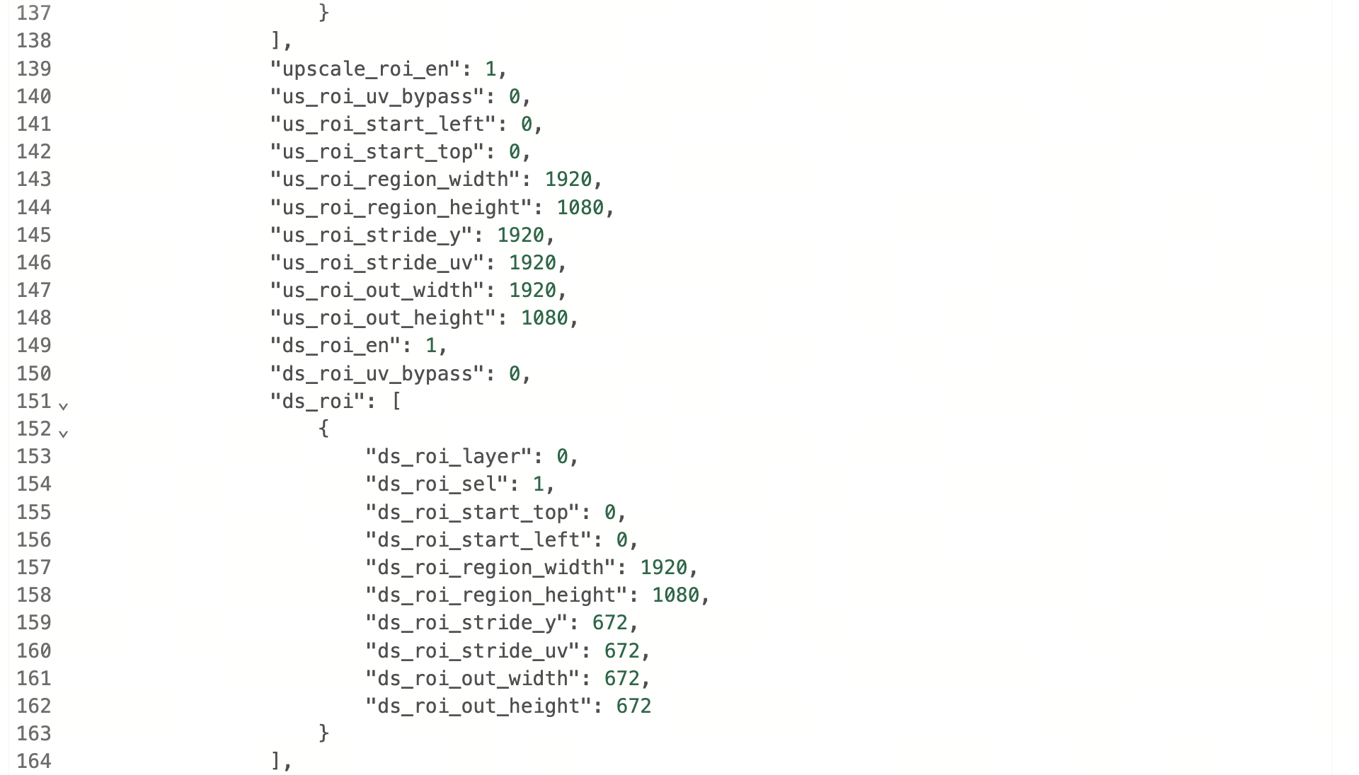

请问可否给一个yolov5x的网络回灌的vpm_config.json配置
其中input tensor 672x672
我配置了一些参数,有的不能生效,有的效果不好
horizon_j5_open_explorer_v1.1.57-py38_20230625\ddk\samples\ai_forward_view_sample\configs\vio\vpm\ddr_pym0_1080p\vpm_config.json
"ds_roi_layer": 0,
"ds_roi_sel": 1,
"ds_roi_start_top": 0,
"ds_roi_start_left": 0,
"ds_roi_region_width": 960,
"ds_roi_region_height": 540,
"ds_roi_stride_y": 512,
"ds_roi_stride_uv": 512,
"ds_roi_out_width": 512, <== 672
"ds_roi_out_height": 512 <== 672
谢谢。。可否给个配置
