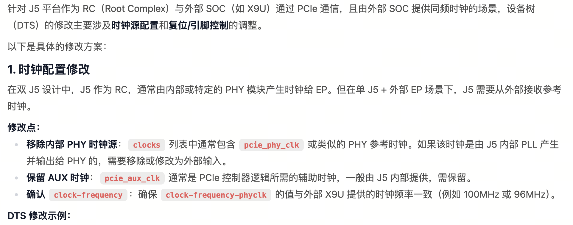

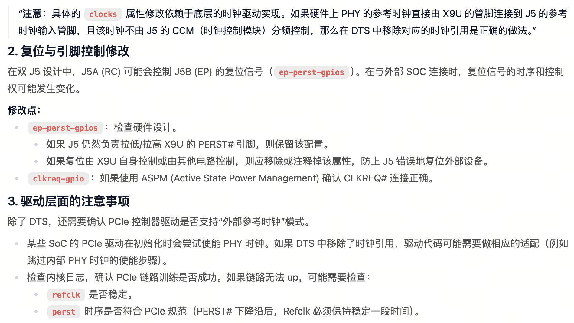

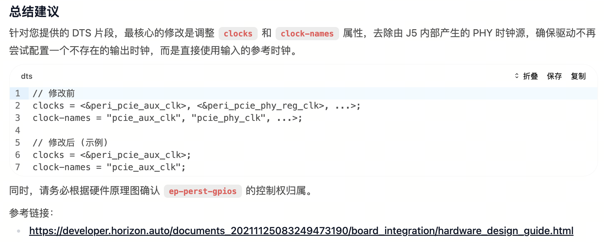

关于J5平台 PCIE的调试的问题请教地平线同事:
平台默认设计:双J5平台默认直连,J5A 作为RC,J5B 作为EP,J5B先上电给J5A提供同频时钟;但是如果单J5 设计,与其他SOC(比如X9U)通过PCIE通信,J5作为RC,X9U作为EP,那么就需要X9U 来提供同频时钟,软件dts如何修改?

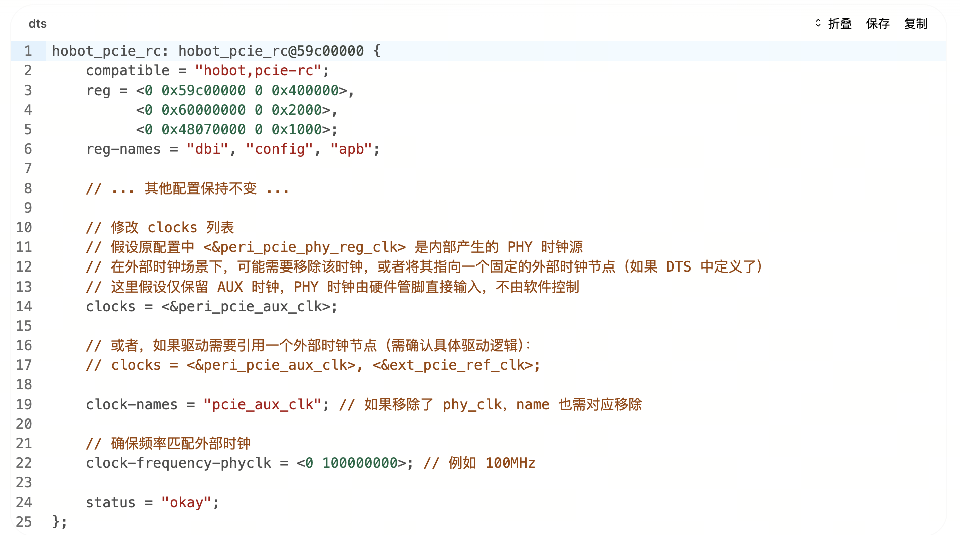

[平台双J5 dts的配置
hobot_pcie_rc: hobot_pcie_rc@59c00000 {
compatible = "hobot,pcie-rc";
reg = <0 0x59c00000 0 0x400000>, /* Controller registers */
<0 0x60000000 0 0x2000>, /* PCI config space */
//<0x4 0x80000000 0 0x2000>, /* 64bit PCI config space */
<0 0x48070000 0 0x1000>; /* apb */
reg-names = "dbi", "config", "apb";
#address-cells = <3>;
#size-cells = <2>;
bus-range = <0x00 0xff>;
ranges = <0x82000000 0 0x60002000 0 0x60002000 0 0x0fffe000>;
//ranges = <0x83000000 0x4 0x80002000 0x4 0x80002000 0x0 0xFFFFE000>; /* 64bit PCI space */
interrupts = <0 94 0x4>, <0 97 0x4>; /* MSI, intc */
#interrupt-cells = <1>;
num-lanes = <2>;
num-viewport = <8>;
status = "disabled";
power-domains = <&pmu PD_PERISYS>;
resets = <&rst_peri 0x0 0>, /* rst_phy */
<&rst_peri 0x0 1>, /* rst_perst */
<&rst_peri 0x0 2>, /* rst_button */
<&rst_peri 0x0 3>, /* rst_powup */
<&rst_peri 0x0 4>; /* rst_apb */
pinctrl-names = "default";
pinctrl-0 = <&ep_perst_func>;
clkreq-gpio = <&port1_b 12 GPIO_ACTIVE_LOW>; /* CLKREQ# */
ep-perst-gpios = <&port1_d 8 GPIO_ACTIVE_HIGH>, /* PEX */
<&port1_c 24 GPIO_ACTIVE_HIGH>; /* M.2 */
clock-frequency-auxclk = <0 96000000>;
clock-frequency-phyclk = <0 96000000>;
clock-names = "pcie_aux_clk", "pcie_phy_clk", "ref_p_clk", "ref_n_clk";
clocks = <&peri_pcie_aux_clk>, <&peri_pcie_phy_reg_clk>, <&safty_pcie_phy_ref_clk>, <&safty_pcie_phy_ref_n_clk>;
如上dts中红色部分,针对单J5,外部提供时钟,软件如何修改?
