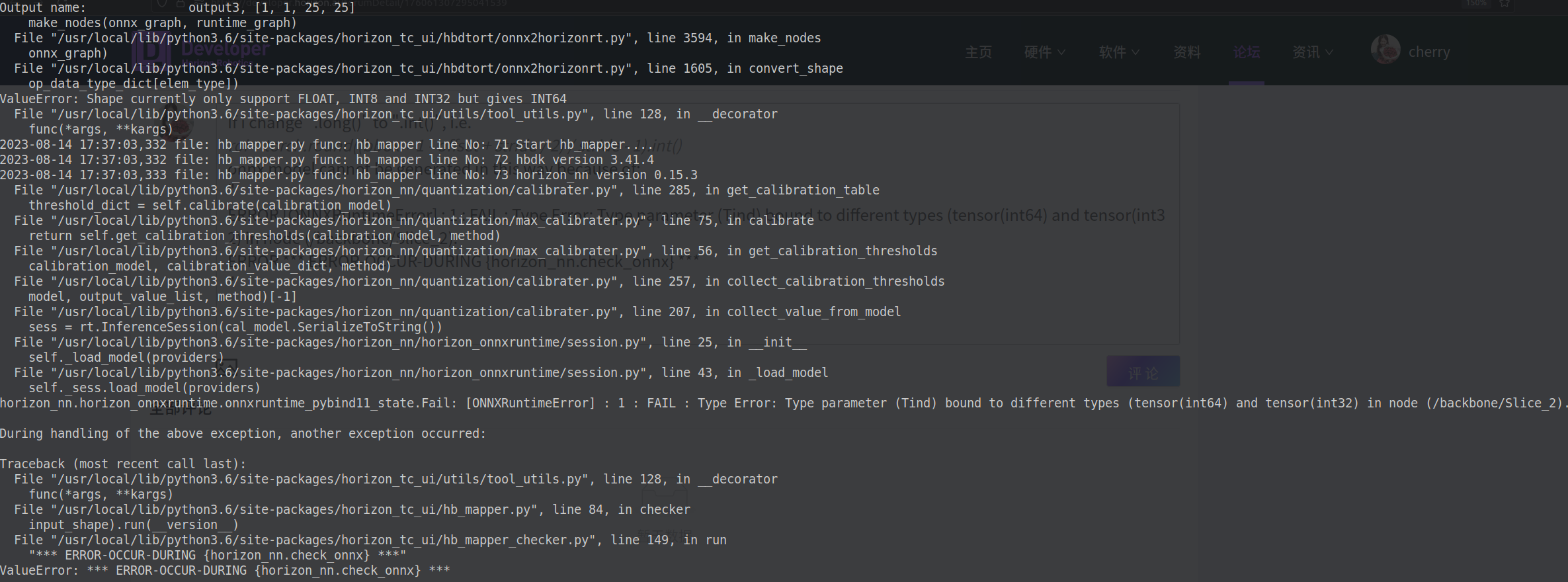

However, when i use "hb_mapper" to check the model, an error appears:
hb_mapper checker --model-type onnx --march bernoulli2 --model SiamGAT.onnx --input-shape input1 1x3x127x127 --input-shape input2 1x3x287x287
hb_mapper_checker.log is in the attached file.

      1. I have tried converting roi.dtype to be "Int32" or "float32", but an error appears:
      TypeError: only integer tensors of a single element can be converted to an index
      This is because our code uses elements in roi as index to execute "slice" operation in the tensor "mask":
      mask[0, :, max(0, roi[0][1]): (min(roi[0][3], 12)), max(0, roi[0][0]): (min(roi[0][2], 12))] = 1
      2. If i change the ".long()" to ".int()", the export from networks into ONNX model makes a success.
      However, when using hb_mapper to check this onnx model(we provide it in [1]), the ai-tool-chain will raise the Type Error mentioned above:
      ERROR [ONNXRuntimeError] : 1 : FAIL : Type Error: Type parameter (Tind) bound to different types (tensor(int64) and tensor(int32) in node (/backbone/Slice_2).
      ERROR *** ERROR-OCCUR-DURING {horizon_nn.check_onnx} ***
      [1]链接:https://pan.baidu.com/s/1ZL8fk8zF5D3CyhefaWQ-zg 提取码:yxwy

      As shown in the following figure, int64 is not supported

    If i change ".long()" to ".int()", i.e.
    roi = torch.round((bbox + 1 - offset + stride / 2) / stride - 1).int()
    onnx model cannot be generated in this way because of:
