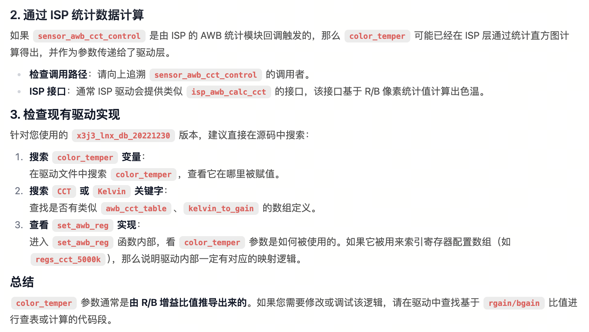

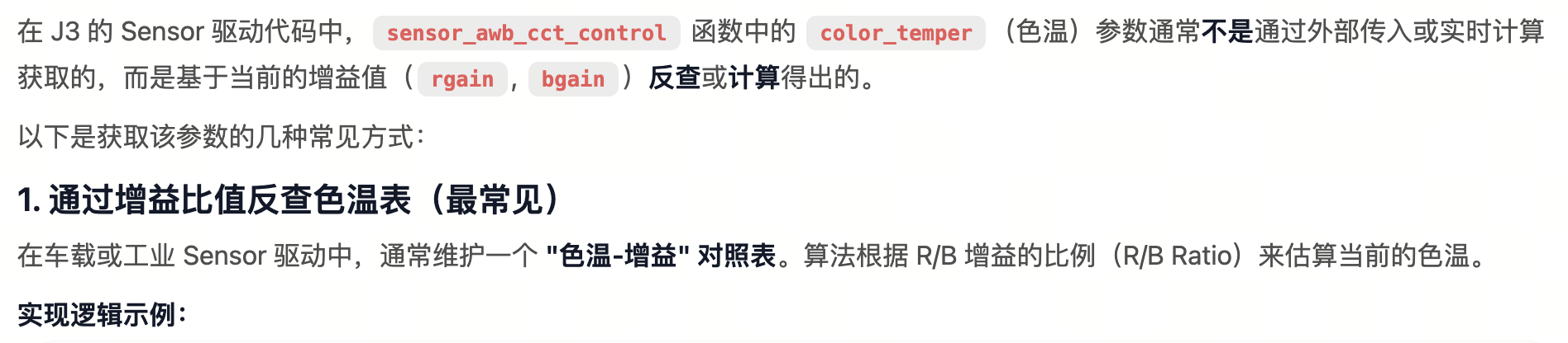

J3 上配置 sensor-awb: 如下函数:
static int sensor_awb_cct_control(hal_control_info_t *info, uint32_t mode, uint32_t rgain,
uint32_t bgain, uint32_t grgain, uint32_t gbgain)
其中 会调用到设置寄存器函数: set_awb_reg(info, rgain, bgain, grgain, gbgain, color_temper);
如此 color_temper 参数如何获取?
