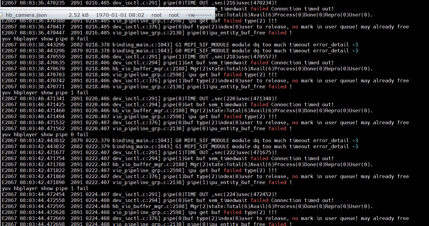

问题描述:
E11006 08:32:35.466884 11017 1955.393 binding_main.c:1043] G0 MIPI_SIF_MODULE module dq too much timeout error_detail -3
E11006 08:32:37.009575 11023 1956.936 dev_ioctl.c:291] pipe(0)TIME OUT ,sec(1957)usec(9574)!
E11006 08:32:37.009659 11023 1956.936 dev_ioctl.c:294] pipe(0)Get buf sem_timedwait failed Connection timed out!
E11006 08:32:37.009695 11023 1956.936 hb_vio_buffer_mgr.c:2108] Mgr(2)state:Total(6)Avail(6)Process(0)Done(0)Repro(0)User(0).
E11006 08:32:37.009728 11023 1956.936 vio_pipeline_grp.c:2598] ipu get buf failed type(2) !!!
E11006 08:32:37.020127 11023 1956.946 dev_ioctl.c:376] pipe(0)buf type(2)index(4)user to release, no mark in user queue! may already free
E11006 08:32:37.020209 11023 1956.946 vio_pipeline_grp.c:2130] pipe(0)ipu_entity_buf_free failed !
yuv hbplayer show pipe 0 fail
J3连接4路imxc390c模组摄像头,调试时,出现该错误,使用hbplayer工具查看不能看到图像。pipe1也存在不稳定状态,出错是报同样的错误。
由于该部分代码不开源,请问出现该问题时需要怎么定位?什么原因导致该问题?怎么修改配置json文件?
