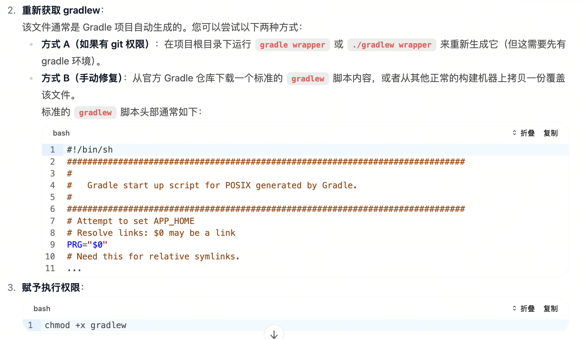

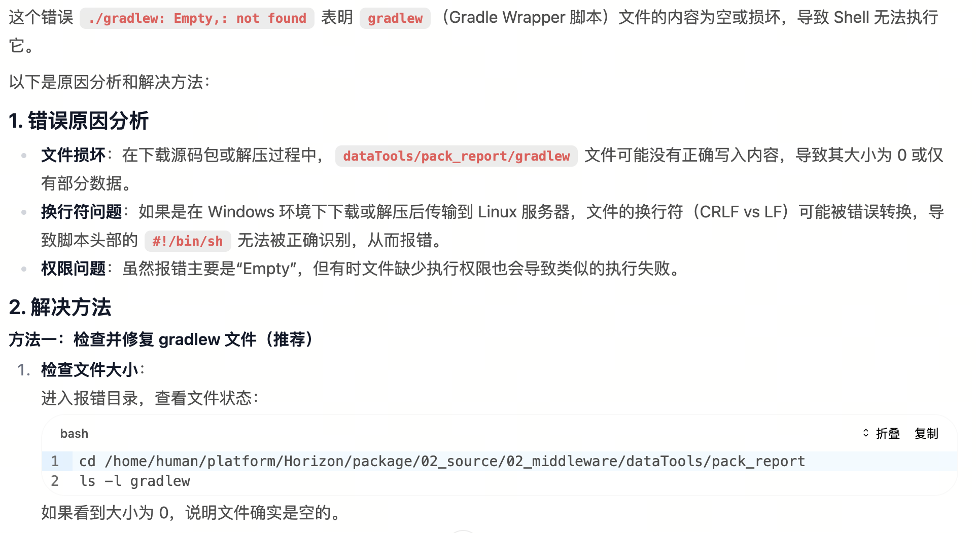

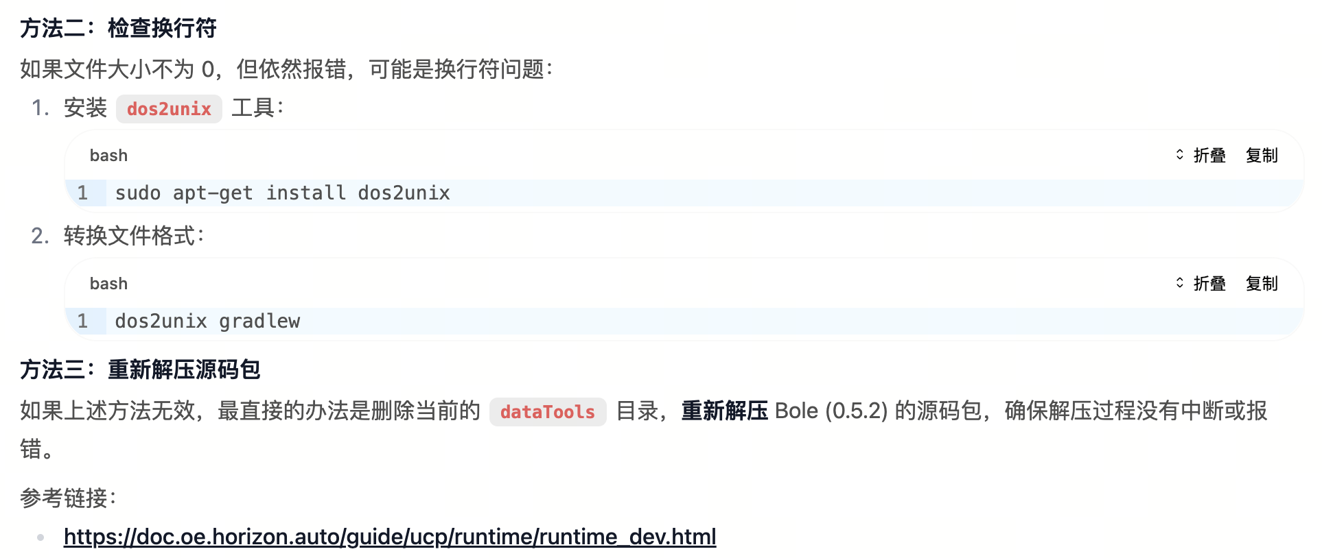

J5平台,在编译Bole(0.5.2) datatool模块时出现下面的错误,请问一下原因?
-- Executing gradle ... -- [1/3] pack_report => /home/human/platform/Horizon/package/02_source/02_middleware/dataTools/pack_report/./gradlew ./gradlew:
1: ./gradlew: Empty,: not found
CMake Error at cmake/macros/macro_add_ext_target.cmake:462 (message):
exec ./gradlew error!
(/home/human/platform/Horizon/package/02_source/02_middleware/dataTools/pack_report) Call Stack (most recent call first):
CMakeLists.txt:115 (EXEC_GRADLE)
