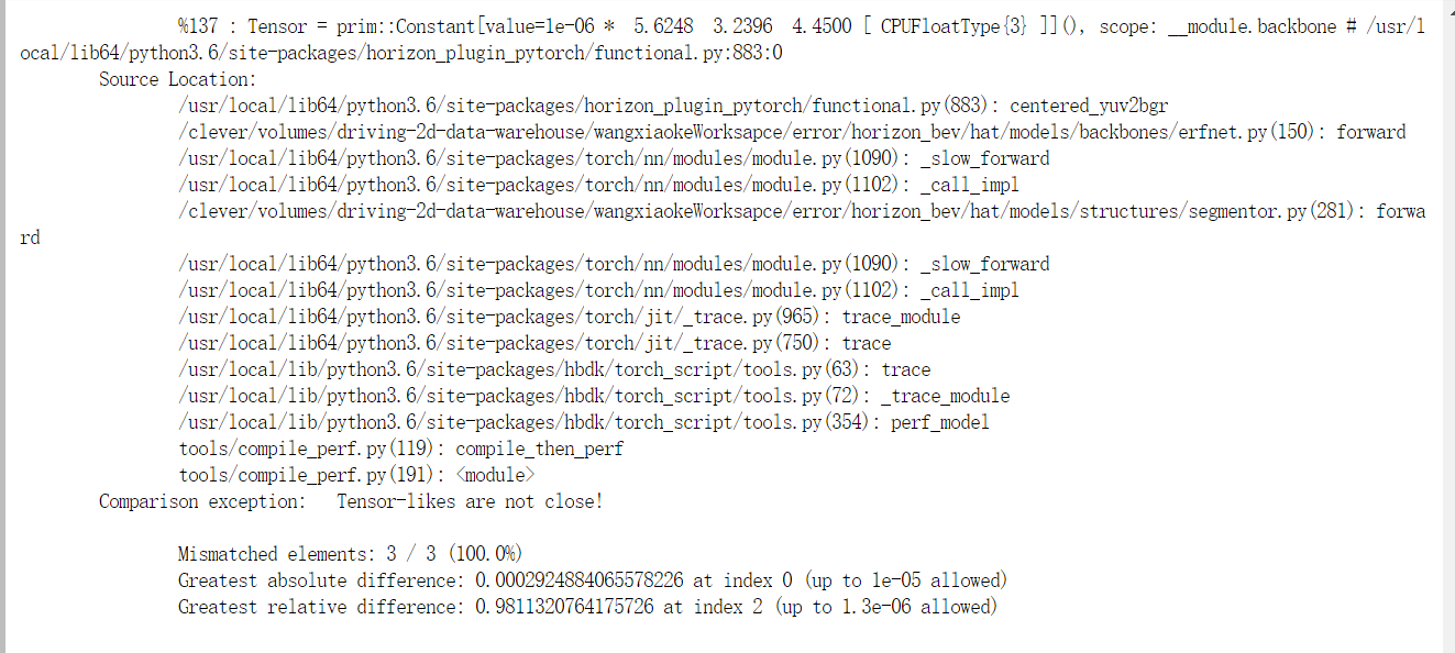

您好,在forwad中插入yuv2rgb/bgr 算子编译hbm报错的问题,错误如下图所示,请教一下大佬哪个环节出错了,谢谢!!
  • 穆心2008
    %137 : Tensor = prim::Constant[value=1e-06 * 5.6248 3.2396 4.4500 [ CPUFloatType{3} ]](), scope: __module.backbone # /usr/local/lib64/python3.6/site-packages/horizon_plugin_pytorch/functional.py:883:0
    Source Location:
    /usr/local/lib64/python3.6/site-packages/horizon_plugin_pytorch/functional.py(883): centered_yuv2bgr

    • 颜值即正义回复穆心2008:
      您好,方便提供更完整一些的报错一些吗?
      另外plugin以及hbdk的版本号是多少?(可通过pip3 list |grep plugin以及pip3 list |grep hbdk查看)
