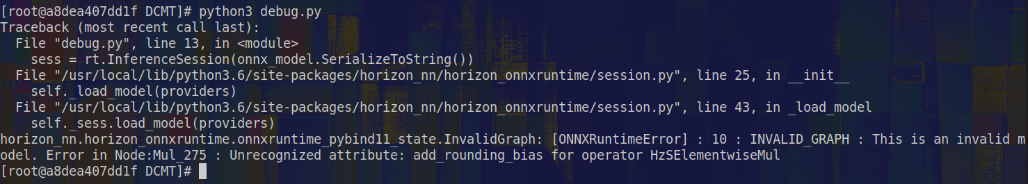

4.问题具体描述:Reports of ONNXRuntimeError are as follows:
The context of debug.py mentioned in picture is as follows:
DCMT_quantized_model.onnx can be found in the below link:

    你好,请问在模型转换编译过程中有报错吗?麻烦提供一下bin模型哈和转换过程中的日志哈

      该问题用户正在使用临时whl包验证,获取链接:https://pan.horizon.ai/index.php/s/Ra3AxDekLW5zqm8

      By using above-mentioned *.whl, the reports of ONNXRuntimeError mentioned in this topic disappears. Details can be found in
      https://developer.horizon.ai/forumDetail/146177165367615512
