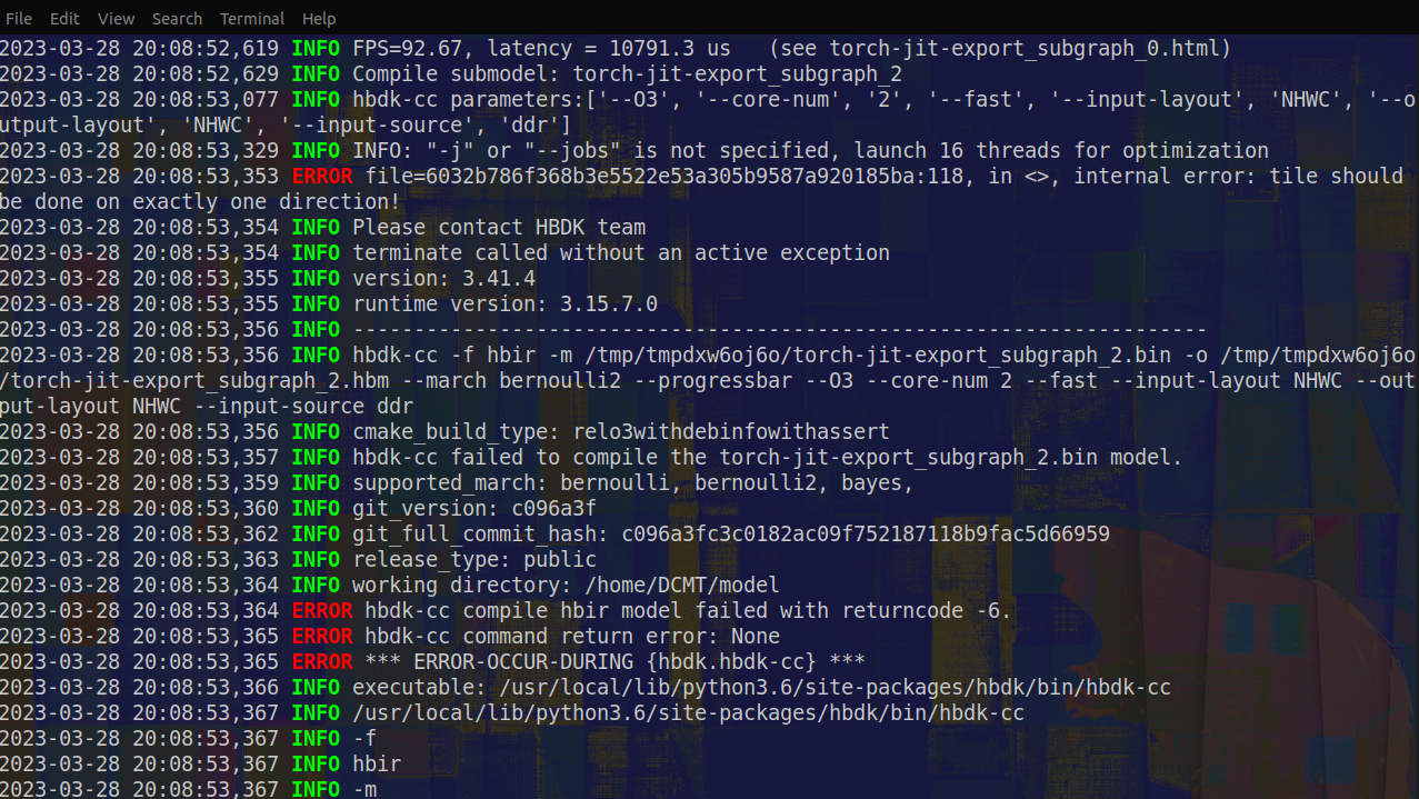

Reports of hbdk-cc error appearing while using toolchain are as follows:
2023-03-28 20:08:53,364 ERROR hbdk-cc compile hbir model failed with returncode -6.
2023-03-28 20:08:53,365 ERROR hbdk-cc command return error: None
2023-03-28 20:08:53,365 ERROR *** ERROR-OCCUR-DURING {hbdk.hbdk-cc} ***
2023-03-28 20:08:53,384 ERROR Please check user manual for hbdk restrictions
The *.onnx model, calibration files and config.yaml can be found as follows:
链接: https://pan.baidu.com/s/1iSlqEVpZ7pz8UCAO4KYm6A 提取码: x94v
PS: the *.onnx model has been verified rationality.

    你好,这个问题可以通过更新临时whl包解决,获取链接:https://pan.horizon.ai/index.php/s/Ra3AxDekLW5zqm8
    使用方式:在docker中先pip uninstall horizon-tc-ui,然后依次pip install hbdk/horizon-nn/horizon-tc-ui即可。
