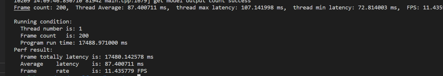

      你好,这个是我在板端推理出来的,在bpu上推理需要247ms,请问这个是需要考虑卷积对齐或者chanel对齐吗

      下面这个是单线程
      "perf_result": {
      "FPS": 11.233394094761993,
      "average_latency": 88.96385955810547
      "running_condition": {
      "core_id": 0,
      "frame_count": 200,
      "model_name": "yolo_shuffletnet",
      "run_time": 17804.058,
      "thread_num": 1
      "chip_latency": {
      "BPU_inference_time_cost": {
      "avg_time": 87.901325,
      "max_time": 105.169,
      "min_time": 78.489
      "CPU_inference_time_cost": {
      "avg_time": 0.8687999999999999,
      "max_time": 1.615,
      "min_time": 0.647
      "model_latency": {
      "BPU_torch-jit-export_subgraph_0": {
      "min_time": 78.489
      "Dequantize_901_HzDequantize": {
      "avg_time": 0.590795,
      "max_time": 1.079,
      "min_time": 0.443
      "Dequantize_921_HzDequantize": {
      "avg_time": 0.14845,
      "max_time": 0.262,
      "min_time": 0.111
      "Dequantize_941_HzDequantize": {
      "avg_time": 0.040835,
      "max_time": 0.087,
      "min_time": 0.028
      "torch-jit-export_subgraph_0_output_layout_convert": {
      "avg_time": 0.08872,
      "max_time": 0.187,
      "min_time": 0.065
      "task_latency": {
      "TaskPendingTime": {
      "avg_time": 0.014060000000000001,
      "max_time": 0.11,
      "min_time": 0.0
      "TaskRunningTime": {
      "avg_time": 88.49078,
      "max_time": 106.825,
      "min_time": 0.0
      2023-02-10
