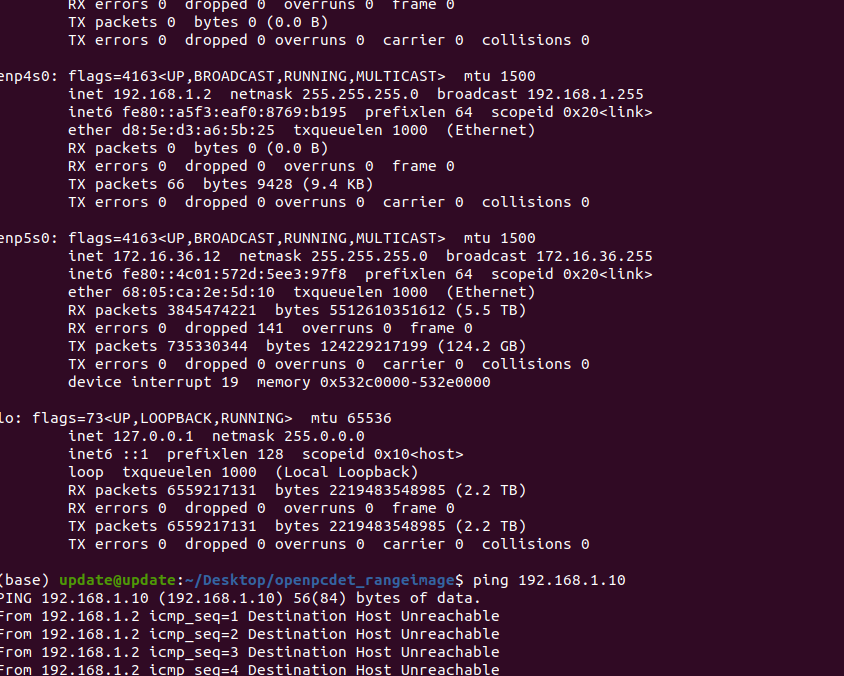

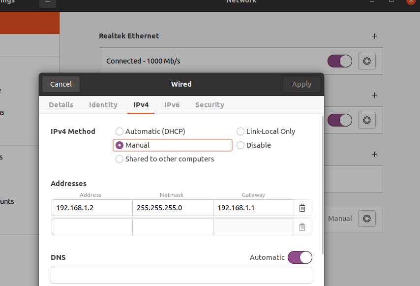

    在板端执行ifconfig,看下eth1的ip是多少;

    • yixinzhang回复新手村:
      docker0: flags=4099 mtu 1500
      inet 172.17.0.1 netmask 255.255.0.0 broadcast 172.17.255.255
      ether 02:42:34:21:75:77 txqueuelen 0 (Ethernet)
      RX packets 0 bytes 0 (0.0 B)
      RX errors 0 dropped 0 overruns 0 frame 0
      TX packets 0 bytes 0 (0.0 B)
      TX errors 0 dropped 0 overruns 0 carrier 0 collisions 0
      enp4s0: flags=4163 mtu 1500
      inet 192.168.1.2 netmask 255.255.255.0 broadcast 192.168.1.255
      inet6 fe80::a5f3:eaf0:8769:b195 prefixlen 64 scopeid 0x20
      ether d8:5e:d3:a6:5b:25 txqueuelen 1000 (Ethernet)
      TX packets 368 bytes 32290 (32.2 KB)
      enp5s0: flags=4163 mtu 1500
      inet 172.16.36.12 netmask 255.255.255.0 broadcast 172.16.36.255
      inet6 fe80::4c01:572d:5ee3:97f8 prefixlen 64 scopeid 0x20
      ether 68:05:ca:2e:5d:10 txqueuelen 1000 (Ethernet)
      RX packets 3848585712 bytes 5517276788854 (5.5 TB)
      RX errors 0 dropped 141 overruns 0 frame 0
      TX packets 736632348 bytes 124323803213 (124.3 GB)
      device interrupt 19 memory 0x532c0000-532e0000
      lo: flags=73 mtu 65536
      inet 127.0.0.1 netmask 255.0.0.0
      inet6 ::1 prefixlen 128 scopeid 0x10
      loop txqueuelen 1000 (Local Loopback)
      RX packets 6562331472 bytes 2219839395150 (2.2 TB)
      TX packets 6562331472 bytes 2219839395150 (2.2 TB)
