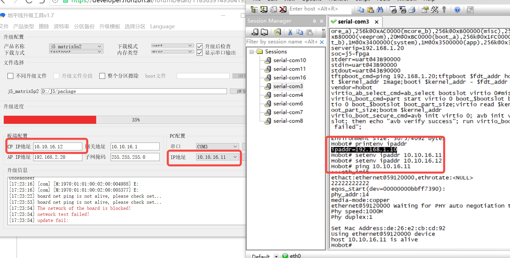

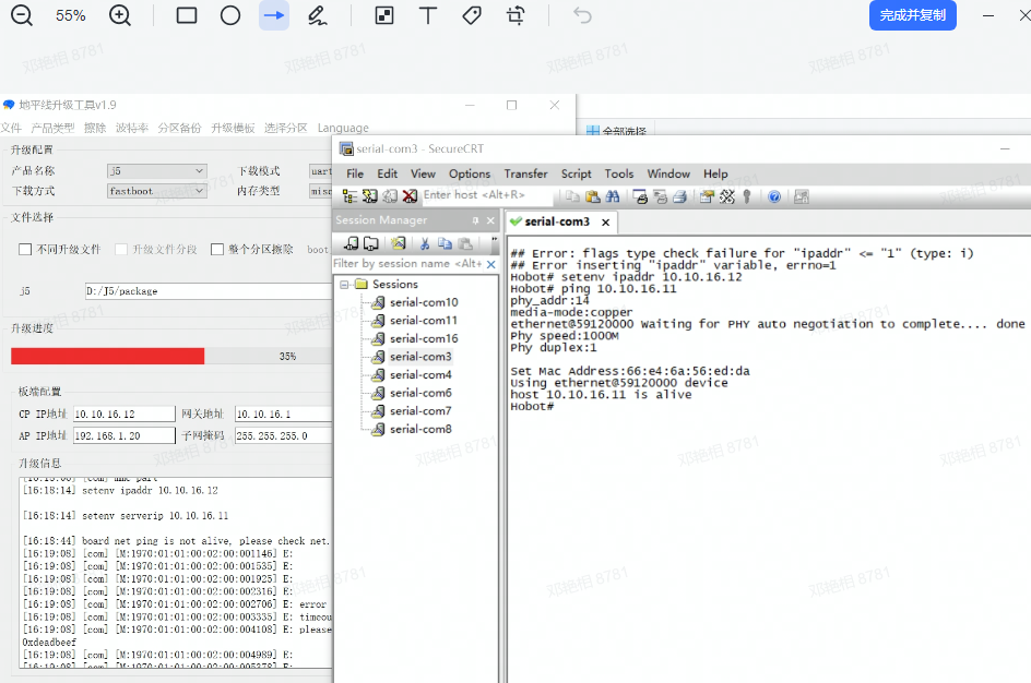

1.硬件获取渠道:自制
2.当前系统镜像版本:
a、单板问题。
b、hbupdate下载报错-board net ping is not alive,please check net...
c、通过串口登录,却可以ping通,见下图
log见附件
评论5
    从log看:[2022-12-06 16:18:04,593] [Update0] [INFO] core.py:92 [com] Listening for fastboot command on 192.168.1.10;
    板子默认设置的IP是不是不对,请检查一下;
    2022-12-06
    • danyxnever回复新手村:
      所有正常的板子都有这一步,这个应该uboot默认的环境变量.
      只有过了这一步后,执行setenv ipaddr/set serverip修改成hbudate界面上的ip,才会去ping测试网络
      2022-12-06
    • 新手村回复danyxnever:
      请问一下,你目前烧写是PC直连板子吗,还是说板子和PC处于同一个内网,进行烧写的?
      2022-12-06
    你可以在uboot模式下 printenv看下 ipaddress是不是你设置的值,从日志看 listening的地址看着是不对的
    2022-12-06
    • danyxnever回复费小财:

      [2022-12-06 15:33:37,003] [Update0] [INFO] core.py:92 [com] Hobot#
      [2022-12-06 15:33:37,505] [Update0] [INFO] core.py:92 [com] printenv serial#
      [2022-12-06 15:33:37,505] [Update0] [INFO] core.py:92 [com] ## Error: "serial#" not defined
      [2022-12-06 15:33:37,506] [Update0] [INFO] core.py:92 [com] Hobot#
      [2022-12-06 15:33:37,506] [Update0] [DEBUG] core.py:363 printenv serial#
      Hobot#
      [2022-12-06 15:33:37,507] [Update0] [DEBUG] transfer_to_board.py:337 can not detect serial number, use serial mode
      [2022-12-06 15:33:37,507] [Update0] [INFO] transfer_to_board.py:73 setenv ipaddr 10.10.16.12
      [2022-12-06 15:33:37,508] [Update0] [INFO] transfer_to_board.py:76 setenv serverip 10.10.16.11
      [2022-12-06 15:33:38,009] [Update0] [INFO] core.py:92 [com] setenv ipaddr 10.10.16.12
      [2022-12-06 15:33:38,010] [Update0] [INFO] core.py:92 [com] Hobot# setenv serverip 10.10.16.11
      [2022-12-06 15:33:38,010] [Update0] [INFO] core.py:92 [com] Hobot# ping 10.10.16.11
      [2022-12-06 15:33:38,011] [Update0] [INFO] core.py:92 [com] phy_addr:14
      [2022-12-06 15:33:38,011] [Update0] [INFO] core.py:92 [com] media-mode:copper
      [2022-12-06 15:33:38,011] [Update0] [INFO] core.py:92 [com] ethernet@59120000 Waiting for PHY auto negotiation to complete.
      [2022-12-06 15:33:39,013] [Update0] [INFO] core.py:92 [com] .
      [2022-12-06 15:33:40,015] [Update0] [INFO] core.py:92 [com] .
      [2022-12-06 15:33:40,516] [Update0] [INFO] core.py:92 [com] .
      [2022-12-06 15:33:41,017] [Update0] [INFO] core.py:92 [com] done
      [2022-12-06 15:33:41,017] [Update0] [INFO] core.py:92 [com] Phy speed:1000M
      [2022-12-06 15:33:41,018] [Update0] [INFO] core.py:92 [com] Phy duplex:1
      [2022-12-06 15:33:41,019] [Update0] [INFO] core.py:92 [com] Set Mac Address:be:c9:4b:76:00:df
      [2022-12-06 15:33:41,019] [Update0] [INFO] core.py:92 [com] Using ethernet@59120000 device
      [2022-12-06 15:33:46,026] [Update0] [INFO] core.py:92 [com] host 10.10.16.11 is alive
      [2022-12-06 15:33:46,026] [Update0] [INFO] core.py:92 [com] Hobot#
      [2022-12-06 15:33:46,027] [Update0] [INFO] transfer_to_board.py:95 before fastboot burn test net ping is OK.
      [2022-12-06 15:33:46,528] [Update0] [DEBUG] transfer_to_board.py:346 printenv fastboot.is-secureboot
      [2022-12-06 15:33:47,029] [Update0] [INFO] core.py:92 [com] printenv fastboot.is-secureboot
      [2022-12-06 15:33:47,029] [Update0] [INFO] core.py:92 [com] fastboot.is-secureboot=yes
      [2022-12-06 15:33:47,030] [Update0] [INFO] core.py:92 [com] Hobot#
      [2022-12-06 15:33:47,030] [Update0] [DEBUG] transfer_to_board.py:351 run fastboot_cmd
      [2022-12-06 15:33:48,031] [Update0] [INFO] transfer_to_board.py:356 cmd:fastboot -s udp:10.10.16.12:5554 getvar pksel
      [2022-12-06 15:33:48,031] [Update0] [DEBUG] core.py:633 cd tools/adb/windows-j5 && fastboot -s udp:10.10.16.12:5554 getvar pksel
      [2022-12-06 15:33:50,191] [Update0] [DEBUG] utils.py:256 error: no response from target
      < waiting for udp:10.10.16.12:5554 >
      pksel: 0
      Finished. Total time: 0.000s
      [2022-12-06 15:33:50,191] [Update0] [INFO] transfer_to_board.py:384 after switch spl_file_name: spl.img0.bin, gpt_file_name: gpt_main-secure.img
      [2022-12-06 15:33:50,191] [Update0] [INFO] transfer_to_board.py:385 start fastboot burn in j5 uboot...
      [2022-12-06 15:33:50,192] [Update0] [INFO] transfer_to_board.py:386 start burn partition: ['gpt', 'sbl', 'all']
      [2022-12-06 15:33:50,193] [Update0] [INFO] transfer_to_board.py:389 cmd:fastboot -s udp:10.10.16.12:5554 flash gpt "D:/J5/package\gpt_main-secure.img"
      正常下载的log里面也有这一步骤的,后面步骤会执行setenv ip/setenv serverip
      2022-12-06
    • 费小财回复danyxnever:
      恩,看后面是网络不通的,你再设置下面2个参数试试
      Hobot# setenv gatewayip 10.10.16.1
      Hobot# setenv netmask 255.255.252.0
      2022-12-06

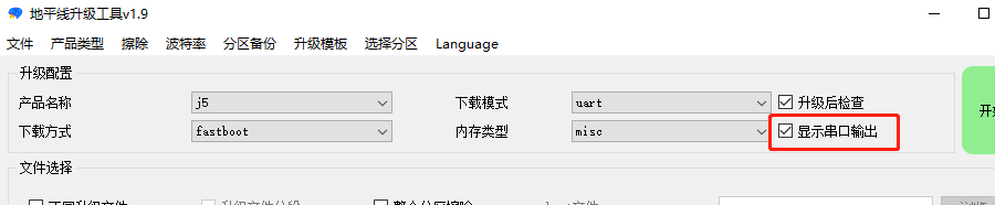

  • Daitao
    从log上看缺少一部分uboot下ping server的log。麻烦确认一下hbupdate工具这个√是够选上了。
    其次您这边J5启动是选择的nor flash吗?目前hbupdate还不支持nor flash的刷写。
    2022-12-06
    • danyxnever回复Daitao:
      选了的,是EMMC启动
