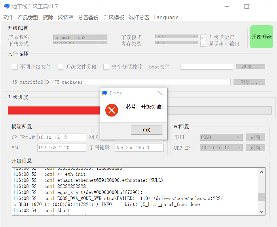

论坛底层软件HBUPDATGE下载报错-EQOS_DMA_MODE_SWR stuckFAILED:-110
danyxnever2022-12-02
34
11
单板问题,下载报上述错误可能是什么原因
+2
评论5
    出现EQOS_DMA_MODE_SWR stuck的时候,表示对端未提供clock给J5 rx clock,考虑是不是对端提供的clock有个时间差。另外最好把串口日志也贴上来,方便进一步分析;
    2022-12-02
    • danyxnever回复新手村:
      [2022-12-02 16:07:55,043] [Update0] [INFO] uart_boot.py:131 send D:/J5/packages/mcore.img.bin before send x2dbg.
      [2022-12-02 16:07:55,104] [Update0] [DEBUG] uart_boot.py:148 D:/J5/packages/mcore.img.bin start 10.000000 end 11.000000
      [2022-12-02 16:07:55,104] [Update0] [INFO] uart_boot.py:149 start load D:/J5/packages/mcore.img.bin
      [2022-12-02 16:07:59,344] [Update0] [INFO] xmodem.py:61 xmodem transmit use CRC
      [2022-12-02 16:08:00,239] [Update0] [INFO] uart_boot.py:167 load success
      [2022-12-02 16:08:00,240] [Update0] [INFO] uart_boot.py:127 wait download...
      [2022-12-02 16:08:02,240] [Update0] [INFO] uart_boot.py:143 wait string before send D:/J5/packages/ddrc.img.bin.
      [2022-12-02 16:08:02,247] [Update0] [DEBUG] uart_boot.py:148 D:/J5/packages/ddrc.img.bin start 11.000000 end 12.509991
      [2022-12-02 16:08:02,247] [Update0] [INFO] uart_boot.py:149 start load D:/J5/packages/ddrc.img.bin
      [2022-12-02 16:08:04,799] [Update0] [INFO] xmodem.py:61 xmodem transmit use CRC
      [2022-12-02 16:08:07,246] [Update0] [INFO] uart_boot.py:167 load success
      [2022-12-02 16:08:07,247] [Update0] [INFO] uart_boot.py:143 wait string before send D:/J5/packages/bl31.img.bin.
      [2022-12-02 16:08:07,664] [Update0] [DEBUG] uart_boot.py:148 D:/J5/packages/bl31.img.bin start 12.509991 end 21.799708
      [2022-12-02 16:08:07,664] [Update0] [INFO] uart_boot.py:149 start load D:/J5/packages/bl31.img.bin
      [2022-12-02 16:08:11,918] [Update0] [INFO] xmodem.py:61 xmodem transmit use CRC
      [2022-12-02 16:08:16,925] [Update0] [INFO] xmodem.py:240 loaded 33%, remaining time is 0m 9s
      [2022-12-02 16:08:21,933] [Update0] [INFO] xmodem.py:240 loaded 66%, remaining time is 0m 4s
      [2022-12-02 16:08:26,893] [Update0] [INFO] uart_boot.py:167 load success
      [2022-12-02 16:08:26,893] [Update0] [INFO] uart_boot.py:143 wait string before send data/board_config/j5/boot_config/boot_file/uboot_deng.img.bin.
      [2022-12-02 16:08:27,183] [Update0] [DEBUG] uart_boot.py:148 data/board_config/j5/boot_config/boot_file/uboot_deng.img.bin start 21.799708 end 30.000000
      [2022-12-02 16:08:27,184] [Update0] [INFO] uart_boot.py:149 start load data/board_config/j5/boot_config/boot_file/uboot_deng.img.bin
      [2022-12-02 16:08:31,437] [Update0] [INFO] xmodem.py:61 xmodem transmit use CRC
      [2022-12-02 16:08:36,444] [Update0] [INFO] xmodem.py:240 loaded 36%, remaining time is 0m 8s
      [2022-12-02 16:08:41,452] [Update0] [INFO] xmodem.py:240 loaded 72%, remaining time is 0m 3s
      [2022-12-02 16:08:45,340] [Update0] [INFO] uart_boot.py:167 load success
      [2022-12-02 16:08:45,340] [Update0] [INFO] uart_boot.py:143 wait string before send data/board_config/j5/boot_config/boot_file/uboot-env.bin.
      [2022-12-02 16:08:45,629] [Update0] [DEBUG] uart_boot.py:148 data/board_config/j5/boot_config/boot_file/uboot-env.bin start 30.000000 end 30.000000
      [2022-12-02 16:08:45,629] [Update0] [INFO] uart_boot.py:149 start load data/board_config/j5/boot_config/boot_file/uboot-env.bin
      [2022-12-02 16:08:49,883] [Update0] [INFO] xmodem.py:61 xmodem transmit use CRC
      [2022-12-02 16:08:49,963] [Update0] [INFO] uart_boot.py:167 load success
      [2022-12-02 16:08:49,966] [Update0] [INFO] core.py:92 [com] x06xyzModem - CRC mode, 0(SOH)/4(STX)/0(CAN) packets, 1 retries
      [2022-12-02 16:08:49,966] [Update0] [DEBUG] core.py:175 try entry linux shell
      [2022-12-02 16:08:51,093] [Update0] [INFO] core.py:92 [com] Loaded 4096 bytes
      [2022-12-02 16:08:51,094] [Update0] [INFO] core.py:92 [com] [BL31:1970:1:1:0:0:58:227586](0) INFO: hb_pm_domain_init map at 0x800fef60
      [2022-12-02 16:08:51,095] [Update0] [INFO] core.py:92 [com] [BL31:1970:1:1:0:0:58:229827](0) INFO: hb_pm_domain_on pmu: 0x800fef38 pd = 1 (camtop)
      [2022-12-02 16:08:51,095] [Update0] [INFO] core.py:92 [com] [BL31:1970:1:1:0:0:58:234370](0) INFO: hb_pm_domain_on pmu: 0x800fef38 pd = 2 (cam_ipe1)
      [2022-12-02 16:08:51,095] [Update0] [INFO] core.py:92 [com] [BL31:1970:1:1:0:0:58:238769](0) INFO: hb_pm_domain_on pmu: 0x800fef38 pd = 3 (videosys)
      [2022-12-02 16:08:51,095] [Update0] [INFO] core.py:92 [com] [BL31:1970:1:1:0:0:58:243491](0) INFO: hb_pm_domain_on pmu: 0x800fef38 pd = 4 (cvtop)
      [2022-12-02 16:08:51,095] [Update0] [INFO] core.py:92 [com] [BL31:1970:1:1:0:0:58:247952](0) INFO: hb_pm_domain_on pmu: 0x800fef38 pd = 5 (cv_vdsp0)
      [2022-12-02 16:08:51,096] [Update0] [INFO] core.py:92 [com] [BL31:1970:1:1:0:0:58:252296](0) INFO: hb_pm_domain_on pmu: 0x800fef38 pd = 6 (cv_vdsp1)
      [2022-12-02 16:08:51,096] [Update0] [INFO] core.py:92 [com] [BL31:1970:1:1:0:0:58:256646](0) INFO: hb_pm_domain_on pmu: 0x800fef38 pd = 18 (bputop0)
      [2022-12-02 16:08:51,096] [Update0] [INFO] core.py:92 [com] [BL31:1970:1:1:0:0:58:262132](0) INFO: hb_pm_domain_on pmu: 0x800fef38 pd = 19 (bpu0_pe0)
      [2022-12-02 16:08:51,096] [Update0] [INFO] core.py:92 [com] [BL31:1970:1:1:0:0:58:266482](0) INFO: hb_pm_domain_on pmu: 0x800fef38 pd = 20 (bpu0_pe1)
      [2022-12-02 16:08:51,096] [Update0] [INFO] core.py:92 [com] [BL31:1970:1:1:0:0:58:270833](0) INFO: hb_pm_domain_on pmu: 0x800fef38 pd = 21 (bpu0_pe2)
      [2022-12-02 16:08:51,096] [Update0] [INFO] core.py:92 [com] [BL31:1970:1:1:0:0:58:275188](0) INFO: hb_pm_domain_on pmu: 0x800fef38 pd = 22 (bpu0_pe3)
      [2022-12-02 16:08:51,096] [Update0] [INFO] core.py:92 [com] [BL31:1970:1:1:0:0:58:279882](0) INFO: hb_pm_domain_on pmu: 0x800fef38 pd = 23 (bputop1)
      [2022-12-02 16:08:51,096] [Update0] [INFO] core.py:92 [com] [BL31:1970:1:1:0:0:58:285373](0) INFO: hb_pm_domain_on pmu: 0x800fef38 pd = 24 (bpu1_pe0)
      [2022-12-02 16:08:51,096] [Update0] [INFO] core.py:92 [com] [BL31:1970:1:1:0:0:58:289732](0) INFO: hb_pm_domain_on pmu: 0x800fef38 pd = 25 (bpu1_pe1)
      [2022-12-02 16:08:51,097] [Update0] [INFO] core.py:92 [com] [BL31:1970:1:1:0:0:58:294094](0) INFO: hb_pm_domain_on pmu: 0x800fef38 pd = 26 (bpu1_pe2)
      [2022-12-02 16:08:51,097] [Update0] [INFO] core.py:92 [com] [BL31:1970:1:1:0:0:58:298458](0) INFO: hb_pm_domain_on pmu: 0x800fef38 pd = 27 (bpu1_pe3)
      [2022-12-02 16:08:51,097] [Update0] [INFO] core.py:92 [com] [BL31:1970:1:1:0:0:58:523952](0) NOTICE: BL31: v2.1(debug):0bab76d
      [2022-12-02 16:08:51,097] [Update0] [INFO] core.py:92 [com] [BL31:1970:1:1:0:0:58:524786](0) NOTICE: BL31: Built : 21:55:04, Apr 7 2022
      [2022-12-02 16:08:51,097] [Update0] [INFO] core.py:92 [com] [BL31:1970:1:1:0:0:58:525745](0) INFO: GICv3 without legacy support detected. ARM GICv3 driver initialized in EL3
      [2022-12-02 16:08:51,097] [Update0] [INFO] core.py:92 [com] [BL31:1970:1:1:0:0:58:527222](0) INFO: GICv3 GICTNS support enable.
      [2022-12-02 16:08:51,097] [Update0] [INFO] core.py:92 [com] [BL31:1970:1:1:0:0:58:528135](0) INFO: tee fw stl inited, module id 5!
      [2022-12-02 16:08:51,097] [Update0] [INFO] core.py:92 [com] [BL31:1970:1:1:0:0:58:529043](0) ERROR: HB_FIREWALL : region 0 is already locked, addr = 0x0000000000000110, mask: 0x0000007f
      [2022-12-02 16:08:51,103] [Update0] [INFO] core.py:92 [com] [BL31:1970:1:1:0:0:58:530637](0) INFO: tee fw stl inited, module id 4!
      [2022-12-02 16:08:51,103] [Update0] [INFO] core.py:92 [com] [BL31:1970:1:1:0:0:58:531538](0) INFO: tee fw stl inited, module id 2!
      [2022-12-02 16:08:51,103] [Update0] [INFO] core.py:92 [com] [BL31:1970:1:1:0:0:58:532444](0) INFO: tee fw stl inited, module id 3!
      [2022-12-02 16:08:51,103] [Update0] [INFO] core.py:92 [com] [BL31:1970:1:1:0:0:58:533351](0) NOTICE: tee_sectrl_fusa_setup_ops set sectrl fusa ops
      [2022-12-02 16:08:51,103] [Update0] [INFO] core.py:92 [com] [BL31:1970:1:1:0:0:58:534428](0) INFO: tee sectrl stl scramble check pass!
      [2022-12-02 16:08:51,103] [Update0] [INFO] core.py:92 [com] [BL31:1970:1:1:0:0:58:535381](0) INFO: tee sectrl stl inited
      [2022-12-02 16:08:51,103] [Update0] [INFO] core.py:92 [com] [BL31:1970:1:1:0:0:58:536185](0) INFO: BL31: Initialising Exception Handling Framework
      [2022-12-02 16:08:51,103] [Update0] [INFO] core.py:92 [com] [BL31:1970:1:1:0:0:58:537281](0) INFO: BL31: Initializing runtime services
      [2022-12-02 16:08:51,103] [Update0] [INFO] core.py:92 [com] [BL31:1970:1:1:0:0:58:538287](0) INFO: hobotd malloc pool setup at 0x80270000, size:0x200000
      [2022-12-02 16:08:51,103] [Update0] [INFO] core.py:92 [com] [BL31:1970:1:1:0:0:58:539455](0) INFO: hobotd sram mempool setup at 0x20018000, size:0x2000
      [2022-12-02 16:08:51,103] [Update0] [INFO] core.py:92 [com] pdu_get_version version 0x8965
      [2022-12-02 16:08:51,103] [Update0] [INFO] core.py:92 [com] spacc->config.num_sec_ctx: 0
      [2022-12-02 16:08:51,103] [Update0] [INFO] core.py:92 [com] SPACC ID: (00008965)
      [2022-12-02 16:08:51,104] [Update0] [INFO] core.py:92 [com] MAJOR : 6
      [2022-12-02 16:08:51,104] [Update0] [INFO] core.py:92 [com] MINOR : 5
      [2022-12-02 16:08:51,104] [Update0] [INFO] core.py:92 [com] QOS : 1
      [2022-12-02 16:08:51,104] [Update0] [INFO] core.py:92 [com] IVIMPORT : 1
      [2022-12-02 16:08:51,104] [Update0] [INFO] core.py:92 [com] TYPE : 0 (SPACC)
      [2022-12-02 16:08:51,104] [Update0] [INFO] core.py:92 [com] AUX : 1
      [2022-12-02 16:08:51,104] [Update0] [INFO] core.py:92 [com] IDX : 0
      [2022-12-02 16:08:51,104] [Update0] [INFO] core.py:92 [com] PARTIAL : 1
      [2022-12-02 16:08:51,104] [Update0] [INFO] core.py:92 [com] PROJECT : 0
      [2022-12-02 16:08:51,104] [Update0] [INFO] core.py:92 [com] SPACC CFG: (17721010)
      [2022-12-02 16:08:51,104] [Update0] [INFO] core.py:92 [com] CTX CNT : 16
      [2022-12-02 16:08:51,104] [Update0] [INFO] core.py:92 [com] RC4 CNT : 16
      [2022-12-02 16:08:51,104] [Update0] [INFO] core.py:92 [com] VSPACC CNT : 2
      [2022-12-02 16:08:51,104] [Update0] [INFO] core.py:92 [com] CIPH SZ : HASH SZ : DMA TYPE : 1 (Scattergather)
      [2022-12-02 16:08:51,104] [Update0] [INFO] core.py:92 [com] MAX PROCLEN: 1048575 bytes
      [2022-12-02 16:08:51,104] [Update0] [INFO] core.py:92 [com] FIFO CONFIG :
      [2022-12-02 16:08:51,104] [Update0] [INFO] core.py:92 [com] CMD0 DEPTH: 8
      [2022-12-02 16:08:51,104] [Update0] [INFO] core.py:92 [com] CMD1 DEPTH: 8
      [2022-12-02 16:08:51,104] [Update0] [INFO] core.py:92 [com] CMD2 DEPTH: 32
      [2022-12-02 16:08:51,104] [Update0] [INFO] core.py:92 [com] STAT DEPTH: 32
      [2022-12-02 16:08:51,104] [Update0] [INFO] core.py:92 [com] [BL31:1970:1:1:0:0:58:547879](0) INFO: Synopsys, Inc. Public Key Accelerator
      [2022-12-02 16:08:51,104] [Update0] [INFO] core.py:92 [com] [BL31:1970:1:1:0:0:58:548852](0) INFO: suppo
      [2022-12-02 16:08:52,107] [Update0] [INFO] core.py:92 [com] rts 4096-bit RSA, 1024-bit ECC with 128-bit ALU
      [2022-12-02 16:08:52,108] [Update0] [INFO] core.py:92 [com] [BL31:1970:1:1:0:0:58:550013](0) INFO: firmware RAM: 0 words, ROM: 4096 words
      [2022-12-02 16:08:52,109] [Update0] [INFO] core.py:92 [com] [BL31:1970:1:1:0:0:58:551014](0) NOTICE: EPN-200a Random Number Generator (stepping: 0)
      [2022-12-02 16:08:52,109] [Update0] [INFO] core.py:92 [com] [BL31:1970:1:1:0:0:58:552096](0) NOTICE: Supports 256-bit output mode
      [2022-12-02 16:08:52,110] [Update0] [INFO] core.py:92 [com] [BL31:1970:1:1:0:0:58:552967](0) NOTICE: Supports true random reseed function
      [2022-12-02 16:08:52,110] [Update0] [INFO] core.py:92 [com] [BL31:1970:1:1:0:0:58:553948](0) INFO: BL31: Preparing for EL3 exit to normal world
      [2022-12-02 16:08:52,110] [Update0] [INFO] core.py:92 [com] [BL31:1970:1:1:0:0:58:555006](0) INFO: Entry point address = 0x88000000
      [2022-12-02 16:08:52,113] [Update0] [INFO] core.py:92 [com] [BL31:1970:1:1:0:0:58:555924](0) INFO: SPSR = 0x3c9
      [2022-12-02 16:08:52,113] [Update0] [INFO] core.py:92 [com] [BL31:1970:1:1:0:0:58:557021](1) INFO: bist: j5_bist_paral_func
      [2022-12-02 16:08:52,113] [Update0] [INFO] core.py:92 [com] U-Boot 2018.09-gfed2490e-dirty (Oct 26 2022 - 17:42:24 +0800) for hobot_j5
      [2022-12-02 16:08:52,113] [Update0] [INFO] core.py:92 [com] +++show_board_info
      [2022-12-02 16:08:52,114] [Update0] [INFO] core.py:92 [com] DRAM: 8 GiB
      [2022-12-02 16:08:52,114] [Update0] [INFO] core.py:92 [com] Flash: +++drivers/core/uclass.c:222/uclass_find_first_device()!
      [2022-12-02 16:08:52,114] [Update0] [INFO] core.py:92 [com] 1111111111ret:0,name:mtd
      [2022-12-02 16:08:52,114] [Update0] [INFO] core.py:92 [com] 222222222222
      [2022-12-02 16:08:52,114] [Update0] [INFO] core.py:92 [com] ## Unknown flash on Bank 1 - Size = 0x00000000 = 0 MB
      [2022-12-02 16:08:52,114] [Update0] [INFO] core.py:92 [com] 0 Bytes
      [2022-12-02 16:08:52,114] [Update0] [INFO] core.py:92 [com] MMC: +++drivers/core/uclass.c:222/uclass_find_first_device()!
      [2022-12-02 16:08:52,114] [Update0] [INFO] core.py:92 [com] 1111111111ret:0,name:mmc
      [2022-12-02 16:08:52,115] [Update0] [INFO] core.py:92 [com] 3333333333333:-1140894432
      [2022-12-02 16:08:52,115] [Update0] [INFO] core.py:92 [com] sdhc@0x48030000: 0, sdhc@0x48040000: 1
      [2022-12-02 16:08:52,115] [Update0] [INFO] core.py:92 [com] Loading Environment from NVRAM... OK
      [2022-12-02 16:08:52,115] [Update0] [INFO] core.py:92 [com] In: uart@43B90000
      [2022-12-02 16:08:52,115] [Update0] [INFO] core.py:92 [com] Out: uart@43B90000
      [2022-12-02 16:08:52,120] [Update0] [INFO] core.py:92 [com] Err: uart@43B90000
      [2022-12-02 16:08:52,120] [Update0] [INFO] core.py:92 [com] Net: +++drivers/core/uclass.c:570/uclass_first_device_check()!
      [2022-12-02 16:08:52,120] [Update0] [INFO] core.py:92 [com] +++drivers/core/uclass.c:222/uclass_find_first_device()!
      [2022-12-02 16:08:52,120] [Update0] [INFO] core.py:92 [com] 1111111111ret:0,name:eth
      [2022-12-02 16:08:52,120] [Update0] [INFO] core.py:92 [com] 222222222222
      [2022-12-02 16:08:52,120] [Update0] [INFO] core.py:92 [com] 3333333333333:-1140888496
      [2022-12-02 16:08:52,120] [Update0] [INFO] core.py:92 [com] +++device_probe
      [2022-12-02 16:08:52,120] [Update0] [INFO] core.py:92 [com] +++eqos_probe
      [2022-12-02 16:08:52,120] [Update0] [INFO] core.py:92 [com] eqos_probe(dev=00000000bbff72c0):
      [2022-12-02 16:08:52,120] [Update0] [INFO] core.py:92 [com] Warning: ethernet@59110000 (eth0) using random MAC address - f6:34:71:fd:eb:a2
      [2022-12-02 16:08:52,120] [Update0] [INFO] core.py:92 [com] ethernet found
      [2022-12-02 16:08:52,120] [Update0] [INFO] core.py:92 [com] eth0: ethernet@59110000+++eqos_probe
      [2022-12-02 16:08:52,120] [Update0] [INFO] core.py:92 [com] eqos_probe(dev=00000000bbff7390):
      [2022-12-02 16:08:52,121] [Update0] [INFO] core.py:92 [com] Warning: ethernet@59120000 (eth1) using random MAC address - be:3e:da:81:7d:8d
      [2022-12-02 16:08:52,121] [Update0] [INFO] core.py:92 [com] , eth1: ethernet@59120000
      [2022-12-02 16:08:52,121] [Update0] [INFO] core.py:92 [com] ---eth_initialize
      [2022-12-02 16:08:52,121] [Update0] [INFO] core.py:92 [com] +++last_stage_init
      [2022-12-02 16:08:52,121] [Update0] [INFO] core.py:92 [com] +++drivers/core/uclass.c:222/uclass_find_first_device()!
      [2022-12-02 16:08:52,121] [Update0] [INFO] core.py:92 [com] 1111111111ret:0,name:spi_flash
      [2022-12-02 16:08:52,121] [Update0] [INFO] core.py:92 [com] 222222222222
      [2022-12-02 16:08:52,121] [Update0] [INFO] core.py:92 [com] 3333333333333:-1140891408
      [2022-12-02 16:08:52,121] [Update0] [INFO] core.py:92 [com] SF: unrecognized JEDEC id bytes: ff, ff, ff, ff, ff, ff
      [2022-12-02 16:08:52,121] [Update0] [INFO] core.py:92 [com] Could not find a valid device for 48020000.cspi
      [2022-12-02 16:08:52,121] [Update0] [INFO] core.py:92 [com] Could not find a valid device for spi6.0
      [2022-12-02 16:08:52,121] [Update0] [INFO] core.py:92 [com] MTD device not found, ret -19
      [2022-12-02 16:08:52,121] [Update0] [INFO] core.py:92 [com] +++chip_last_stage_init
      [2022-12-02 16:08:52,121] [Update0] [INFO] core.py:92 [com] 1111111111ret:0,name:pci
      [2022-12-02 16:08:52,121] [Update0] [INFO] core.py:92 [com] 3333333333333:-1140894672
      [2022-12-02 16:08:52,121] [Update0] [INFO] core.py:92 [com] ---chip_last_stage_init
      [2022-12-02 16:08:52,121] [Update0] [INFO] core.py:92 [com] boot_mode: 3
      [2022-12-02 16:08:52,121] [Update0] [INFO] core.py:92 [com] ANDROID: Booting slot: a
      [2022-12-02 16:08:52,121] [Update0] [INFO] core.py:92 [com] setup_boot_action: boot action 0x5242c309
      [2022-12-02 16:08:52,121] [Update0] [INFO] core.py:92 [com] setup_boot_action: enter fastboot!
      [2022-12-02 16:08:52,121] [Update0] [INFO] core.py:92 [com] 1111111111ret:0,name:eth
      [2022-12-02 16:08:52,121] [Update0] [INFO] core.py:92 [com] 3333333333333:-1140888496
      [2022-12-02 16:08:52,122] [Update0] [INFO] core.py:92 [com] +++eth_init
      [2022-12-02 16:08:52,122] [Update0] [INFO] core.py:92 [com] ethact:ethernet@59120000,ethrotate:
      [2022-12-02 16:08:52,122] [Update0] [INFO] core.py:92 [com] 22222222222
      [2022-12-02 16:08:52,122] [Update0] [INFO] core.py:92 [com] eqos_start(dev=00000000bbff7390):
      [2022-12-02 16:08:52,122] [Update0] [INFO] core.py:92 [com] EQOS_DMA_MODE_SWR stuckFAILED: -110+++drivers/core/uclass.c:222/u[BL31:1970:1:1:0:0:59:141782](1) INFO: bist: j5_bist_paral_func done
      [2022-12-02 16:08:53,232] [Update0] [DEBUG] core.py:175 try entry linux shell
      [2022-12-02 16:08:54,235] [Update0] [INFO] core.py:92 [com] Abort
      [2022-12-02 16:08:54,235] [Update0] [INFO] core.py:92 [com] fastboot udp error: -4

      2022-12-05
    • 新手村回复danyxnever:
      麻烦贴一下串口日志,单板EQOS_DMA_MODE_SWR报错,需要看下串口日志报啥错;谢谢
      2022-12-05
  • danyxnever
    Hobot# mii dump 0x0E 0-2
    0. (1140) -- PHY control register --
    (8000:0000) 0.15 = 0 reset
    (4000:0000) 0.14 = 0 loopback
    (2040:0040) 0. 6,13 = b10 speed selection = 1000 Mbps
    (1000:1000) 0.12 = 1 A/N enable
    (0800:0000) 0.11 = 0 power-down
    (0400:0000) 0.10 = 0 isolate
    (0200:0000) 0. 9 = 0 restart A/N
    (0100:0100) 0. 8 = 1 duplex = full
    (0080:0000) 0. 7 = 0 collision test enable
    (003f:0000) 0. 5- 0 = 0 (reserved)
    1. (7949) -- PHY status register --
    (8000:0000) 1.15 = 0 100BASE-T4 able
    (4000:4000) 1.14 = 1 100BASE-X full duplex able
    (2000:2000) 1.13 = 1 100BASE-X half duplex able
    (1000:1000) 1.12 = 1 10 Mbps full duplex able
    (0800:0800) 1.11 = 1 10 Mbps half duplex able
    (0400:0000) 1.10 = 0 100BASE-T2 full duplex able
    (0200:0000) 1. 9 = 0 100BASE-T2 half duplex able
    (0100:0100) 1. 8 = 1 extended status
    (0080:0000) 1. 7 = 0 (reserved)
    (0040:0040) 1. 6 = 1 MF preamble suppression
    (0020:0000) 1. 5 = 0 A/N complete
    (0010:0000) 1. 4 = 0 remote fault
    (0008:0008) 1. 3 = 1 A/N able
    (0004:0000) 1. 2 = 0 link status
    (0002:0000) 1. 1 = 0 jabber detect
    (0001:0001) 1. 0 = 1 extended capabilities
    2. (0141) -- PHY ID 1 register --
    (ffff:0141) 2.15- 0 = 321 OUI portion
    0. (ffff) -- PHY control register --
    (8000:8000) 0.15 = 1 reset
    (4000:4000) 0.14 = 1 loopback
    (2040:2040) 0. 6,13 = b11 speed selection = 10 Mbps
    (0800:0800) 0.11 = 1 power-down
    (0400:0400) 0.10 = 1 isolate
    (0200:0200) 0. 9 = 1 restart A/N
    (0080:0080) 0. 7 = 1 collision test enable
    (003f:003f) 0. 5- 0 = 63 (reserved)
    1. (ffff) -- PHY status register --
    (8000:8000) 1.15 = 1 100BASE-T4 able
    (0400:0400) 1.10 = 1 100BASE-T2 full duplex able
    (0200:0200) 1. 9 = 1 100BASE-T2 half duplex able
    (0080:0080) 1. 7 = 1 (reserved)
    (0020:0020) 1. 5 = 1 A/N complete
    (0010:0010) 1. 4 = 1 remote fault
    (0004:0004) 1. 2 = 1 link status
    (0002:0002) 1. 1 = 1 jabber detect
    2. (ffff) -- PHY ID 1 register --
    (ffff:ffff) 2.15- 0 = 65535 OUI portion
    通过miidump 大部分时间读到的都是1,偶尔能读出1,0的状态,同时测量88EA1512给J5的RX_CLK时有时无
    2022-12-05
    • 新手村回复danyxnever:
      你好:
      88EA1512给J5的RX_CLK时有时无, 大概率是phy时钟或电压不稳,麻烦请检查单板电路;
      2022-12-06
    • danyxnever回复新手村:
      谢谢,已解决,phy 复位信号异常导致
      2022-12-06
