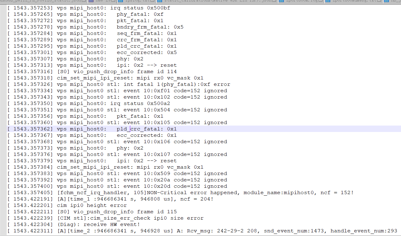

      lane speed 配置的是对的。发现解串器发送deskew消息,地平线soc的dphy芯片会有下面的报错信息。 地平线的dphy芯片对deskew消息有什么要求吗,譬如initial calibration,校准长度之类的。
      vps mipi_host0: irq status 0x500bf vps mipi_host0: phy_fatal: 0xf vps mipi_host0: pkt_fatal: 0x1 vps mipi_host0: bndry_frm_fatal: 0x5 vps mipi_host0: seq_frm_fatal: 0x1 vps mipi_host0: crc_frm_fatal: 0x1 vps mipi_host0: pld_crc_fatal: 0x1 vps mipi_host0: ecc_corrected: 0x5 vps mipi_host0: phy: 0x2 vps mipi_host0: ipi: 0x2 vps mipi_host0: irq status 0x500bf vps mipi_host0: phy_fatal: 0xf vps mipi_host0: pkt_fatal: 0x1 vps mipi_host0: bndry_frm_fatal: 0x5 vps mipi_host0: seq_frm_fatal: 0x1 vps mipi_host0: crc_frm_fatal: 0x1 vps mipi_host0: pld_crc_fatal: 0x1 vps mipi_host0: ecc_corrected: 0x5 vps mipi_host0: phy: 0x2 vps mipi_host0: ipi: 0x2 --> reset [S0] vio_push_drop_info frame id 114 cim_set_mipi_ipi_reset: mipi rx0 vc_mask 0x1 vps mipi_host0 stl: int fatal 1(phy_fatal):0xf error vps mipi_host0 stl: event 10:0xf01 code=152 ignored vps mipi_host0 stl: event 10:0x102 code=152 ignored vps mipi_host0: irq status 0x500a2 vps mipi_host0 stl: event 10:0x504 code=152 ignored vps mipi_host0: pkt_fatal: 0x1 vps mipi_host0 stl: event 10:0x105 code=152 ignored vps mipi_host0: pld_crc_fatal: 0x1 vps mipi_host0: ecc_corrected: 0x1 vps mipi_host0 stl: event 10:0x106 code=152 ignored vps mipi_host0: phy: 0x2 vps mipi_host0 stl: event 10:0x107 code=152 ignored vps mipi_host0: ipi: 0x2 reset [S0] vio_push_drop_info frame id 114 cim_set_mipi_ipi_reset: mipi rx0 vc_mask 0x1 vps mipi_host0 stl: int fatal 1(phy_fatal):0xf error vps mipi_host0 stl: event 10:0xf01 code=152 ignored vps mipi_host0 stl: event 10:0x102 code=152 ignored vps mipi_host0: irq status 0x500a2 vps mipi_host0 stl: event 10:0x504 code=152 ignored vps mipi_host0: pkt_fatal: 0x1 vps mipi_host0 stl: event 10:0x105 code=152 ignored vps mipi_host0: pld_crc_fatal: 0x1 vps mipi_host0: ecc_corrected: 0x1 vps mipi_host0 stl: event 10:0x106 code=152 ignored vps mipi_host0: phy: 0x2 vps mipi_host0 stl: event 10:0x107 code=152 ignored vps mipi_host0: ipi: 0x2 --> reset cim_set_mipi_ipi_reset: mipi rx0 vc_mask 0x1
      2024-12-30
    • szc:
      [ 1543.357384] cim_set_mipi_ipi_reset: mipi rx0 vc_mask 0x1 [ 1543.357383] vps mipi_host0 stl: event 10:0x509 code=152 ignored [ 1543.357392] vps mipi_host0 stl: event 10:0x20a code=152 ignored [ 1543.357400] vps mipi_host0 stl: event 10:0x20d code=152 ignored [ 1543.357405] [fchm_ncf_irq_handler, 105]NON-Critical error happened, module_name:mipihost0, ncf = 152! [ 1543.422191] [A][time_1 :946686341 s, 946808 us], ncf = 204! [ 1543.422201] cim ipi0 height error [ 1543.422211] [S0] vio_push_drop_info frame id 115 [ 1543.422239] [CIM stl]:cim_size_err_check ipi0 size error

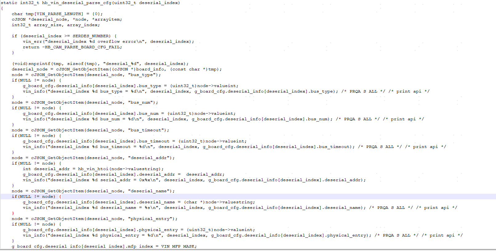

    • szc回复费小财:
      hb_vin_deserial_parse_cfg 这个函数中没有解析 lane speed ,即使 json 文件配置了 lane speed ,也不会有打印的和起作用的。下面是这个函数的截图
      2024-12-31
    • szc:
      2024-12-31

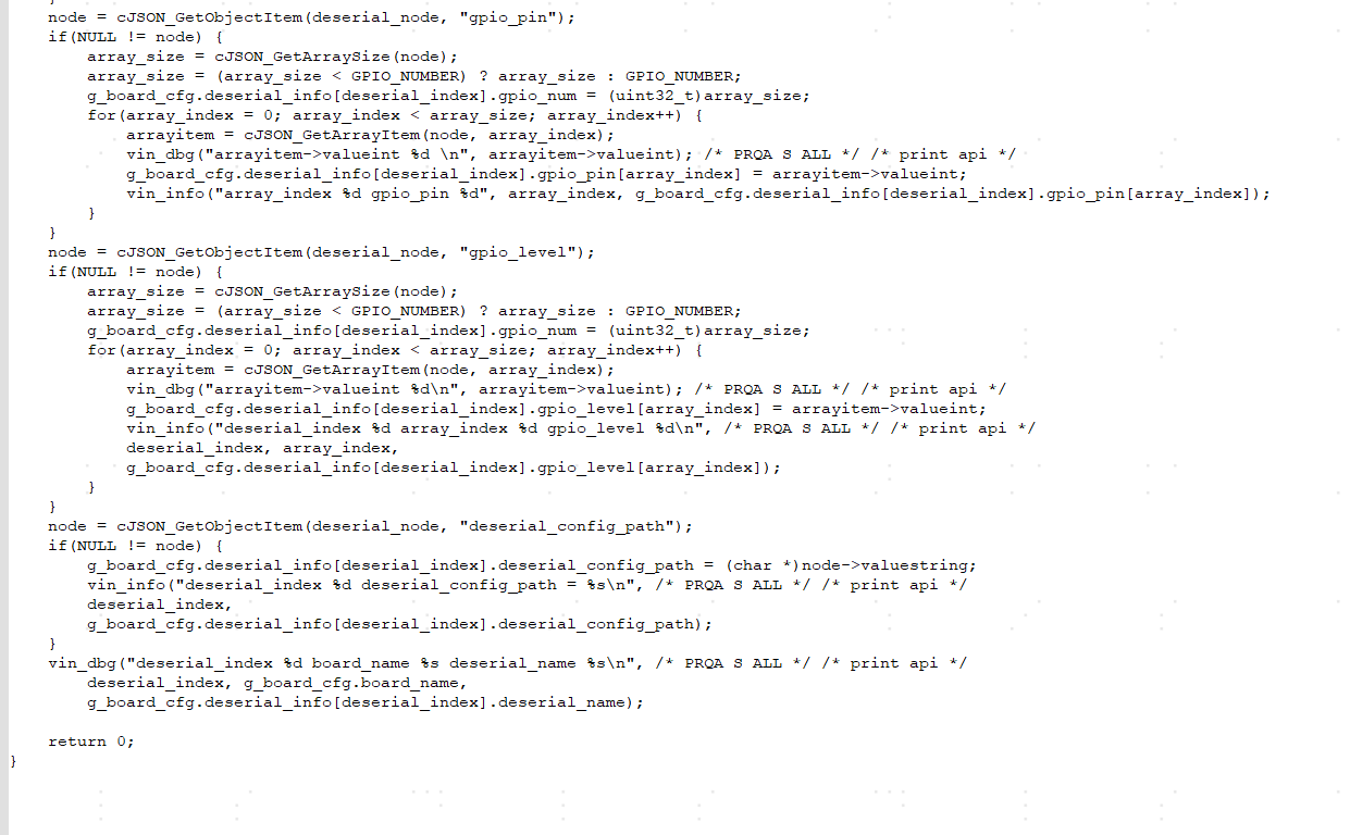

    • szc回复费小财:
      函数对应的文件夹中的代码也没有找到,搜了 cJSON_GetObjectItem 和hb_vin_mipi_host_parse_int 调用的代码,也没有找到lane_speed 。你帮忙找下吧。谢谢

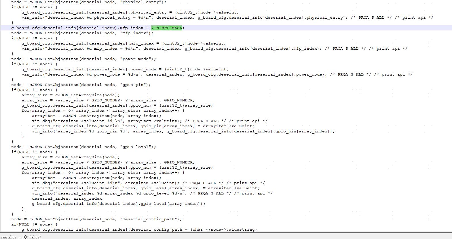

    • szc回复费小财:
      没有 lane_speed 代码, 如下的代码截图,deserial_name 之前解析的是 deserial_addr。你这个代码版本是多少?我能够从立昇那里获取到吗?

    • szc回复费小财:
      不行,缺的代码比较多, g_board_cfg.deserial_info 数据结构中 也没有定义 lane_speed
