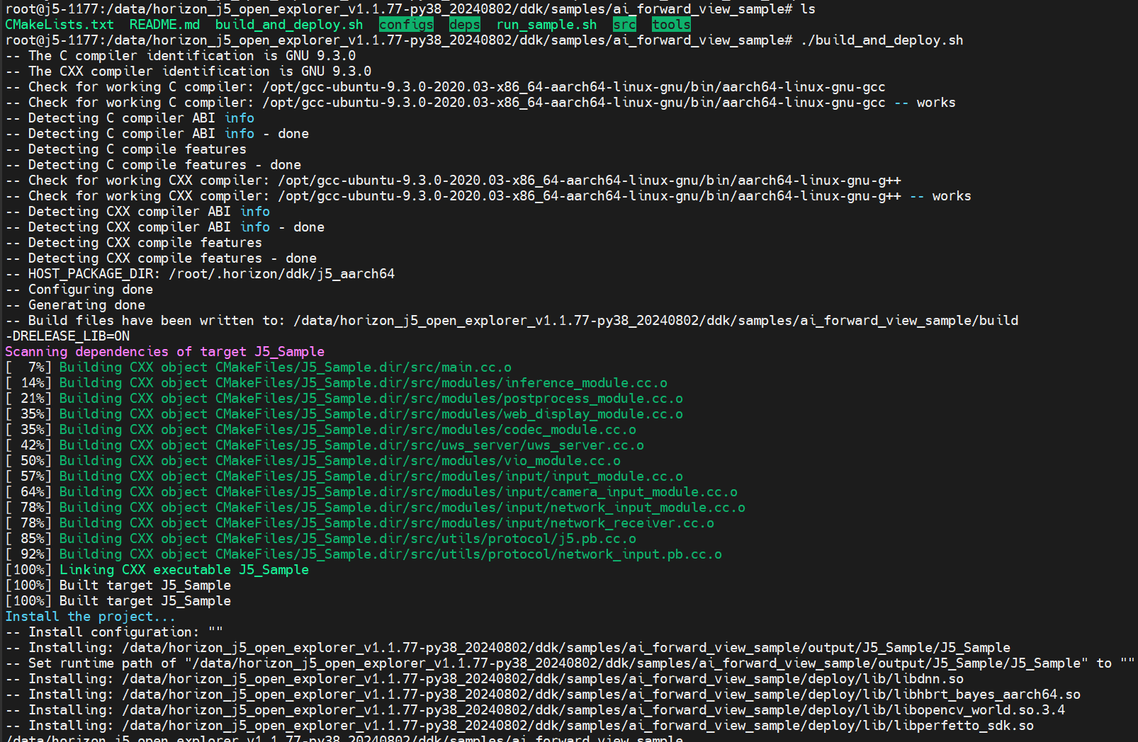

在运行horizon_j5_open_explorer_v1.1.77-py38_20240802的ai_forward_view_sample时报错:运行bash build_and_deploy.sh
报错:
[ 78%] Building CXX object CMakeFiles/J5_Sample.dir/src/modules/input/network_input_module.cc.o [ 78%] Building CXX object CMakeFiles/J5_Sample.dir/src/modules/input/network_receiver.cc.o [ 85%] Building CXX object CMakeFiles/J5_Sample.dir/src/utils/protocol/j5.pb.cc.o [ 92%] Building CXX object CMakeFiles/J5_Sample.dir/src/utils/protocol/network_input.pb.cc.o [100%] Linking CXX executable J5_Sample /opt/gcc-ubuntu-9.3.0-2020.03-x86_64-aarch64-linux-gnu/bin/../lib/gcc-cross/aarch64-linux-gnu/9/../../../../aarch64-linux-gnu/bin/ld:/open_explorer/ddk/samples/ai_forward_view_sample/deps/aarch64/zlib/lib/libz.so: file format not recognized; treating as linker script /opt/gcc-ubuntu-9.3.0-2020.03-x86_64-aarch64-linux-gnu/bin/../lib/gcc-cross/aarch64-linux-gnu/9/../../../../aarch64-linux-gnu/bin/ld:/open_explorer/ddk/samples/ai_forward_view_sample/deps/aarch64/zlib/lib/libz.so:0: syntax error collect2: error: ld returned 1 exit status make[2]: *** [CMakeFiles/J5_Sample.dir/build.make:264: J5_Sample] Error 1 make[1]: *** [CMakeFiles/Makefile2:73: CMakeFiles/J5_Sample.dir/all] Error 2 make: *** [Makefile:130: all] Error 2 failed to build
    收到,以后报错内容还是截屏吧,看着舒服点xiaoku_org.svg
    2024-12-27
    有几个事情需要同步给你:
    1.从你给的错误信息看,是链接时报错,请确认一下:1. 是在DOCKER环境下编译的;2. 库文件和交叉编译库没有修改过。
    2. 使用 J5 原始的1.1.77的docker以及OE是没有问题的,一方面我们发包时进行可用性测试,另一方面我有double check了一下,结论是没有问题!
    3. 建议:从新解压OE包并构建一个新的容器,进行编译,无需在原本OK的事情上浪费时间。
