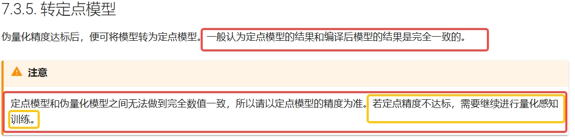

    • HuangHui回复默认82368:
      2025-01-23
