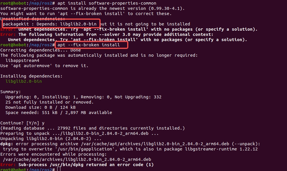

debian12系统的J6E,是否支持ROS2。
安装ROS2基础环境一直报错, 另外apt安装的, 下次开机还是会刷掉

    安装步骤和报错日志请帮忙贴下,谢谢

      报错贴了一张图,在装ros需要的基础环境的时候报错了

    • 沃德菲回复Sunny黎晶晶:
      我本地安装apt install software-properties-common成功的,cat /proc/version看下你的版本信息

    • 沃德菲回复Sunny黎晶晶:
      成功log:root@hobot:~# apt install software-properties-common Reading package lists... Done Building dependency tree... Done Reading state information... Done The following additional packages will be installed: appstream dirmngr distro-info-data gir1.2-glib-2.0 gir1.2-packagekitglib-1.0 gnupg gnupg-l10n gnupg-utils gpg gpg-agent gpg-wks-client gpg-wks-server gpgconf gpgsm iso-codes libappstream4 libassuan0 libgirepository-1.0-1 libglib2.0-bin libglib2.0-data...
      Processing triggers for libc-bin (2.36-9+deb12u10) ... Setting up python3-software-properties (0.99.30-4.1~deb12u1) ... Setting up software-properties-common (0.99.30-4.1~deb12u1) ... Processing triggers for dbus (1.14.10-1~deb12u1) ...
