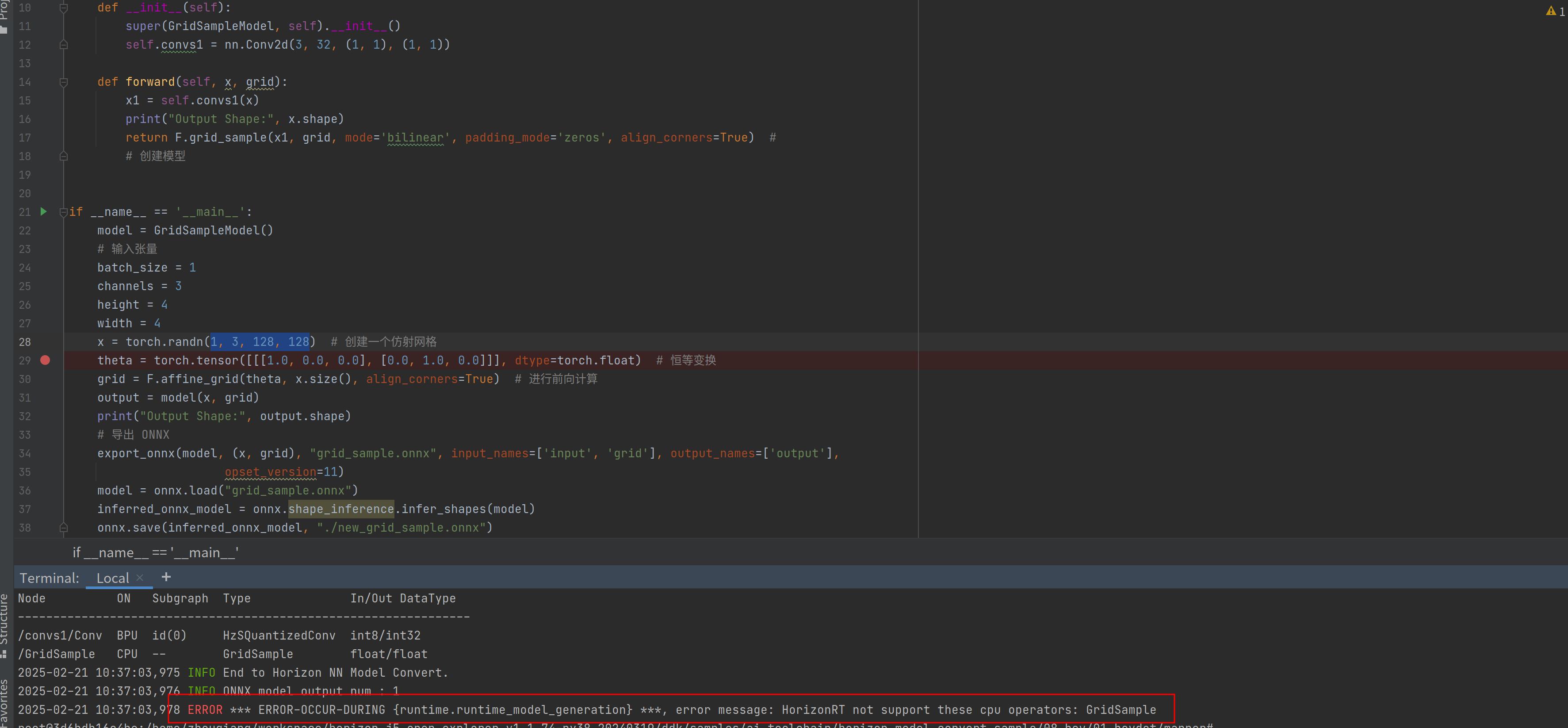

gridsample算子无法转换
1.1.74GPU开发环境
/convs1/Conv BPU id(0) HzSQuantizedConv int8/int32 /GridSample CPU -- GridSample float/float 2025-02-21 10:37:03,975 INFO End to Horizon NN Model Convert. 2025-02-21 10:37:03,976 INFO ONNX model output num : 1 2025-02-21 10:37:03,978 ERROR *** ERROR-OCCUR-DURING {runtime.runtime_model_generation} ***, error message: HorizonRT not support these cpu operators: GridSample

    • HuangHui回复ZQQ:
      你好 ,
      我复现了你的代码 ,可以导出来呀
      2025-02-21
    • HuangHui回复HuangHui:
      你的export_onnx是通过地平线包里面的吧,这里需要用torch导出来
      2025-02-21
